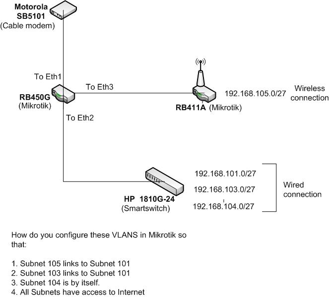

In my excitement with the solution given, I forgot to properly check that all VLANS have traffic going through. I feel somewhat embarrassed to have to come back asking for more help.
But after several trials during the last few days, I am still unable to get Mikrotik to let traffic going through the remaining VLANS. As indicated on the Interface page, VLAN 101 has Tr and Rx traffic running through normally but this is not the case with the remaining VLANS.
Again I’d appreciate your help with this issue.
The attached diagram shows of what I set out to achieve:
And here is my current setting:

Thank you in anticipation.
Can the other VLANs ping the router?
Hi Netrat,
No, they can not ping the router. Neither can they ping the gateway of their own subnets.
But from a PC in VLAN101, I can ping all ‘default gateways’ of these VLANS, i.e . 192.168.103.1, 192.168.104.1 & 192.168.105.1 alas but not the individual IP of a node in one of these subnets.
I am confused.
Thank you for coming back.
If they can’t ping the router or each other then I think you need to check the configuration on your switch.
Netrat,
With perserverance and ‘faith’ in your suggestion, and after a few more hairs falling out of my head, I ‘managed’ to get the HP Procurve 1810’s settings correct and traffic now flows through wired VLANS as water under the bridge. I like the metaphor since no bridge is used for crossing-over purposes. I also checked to be sure that all traffic flowing through all VLANS this time just to be sure. :wink:
This brings me to the remaining issue and just wonder if you can be so kind again. No Internet from my wifi connection.
I can connect with the RB411A but cannot get to the Net. It says no gateway reply. I can not assess the RB411A either from Winbox.
Thank you.
