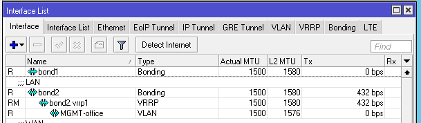

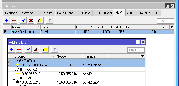

Mikrotik
interface Vlan50
ip address 192.168.90.120 255.255.255.0
When I assign the VLAN-interface to the physical interface, it pings from switch.
When I assign the VLAN-interface to the VRRP-interface, it not available from switch.

That’s because your mixing concepts, a VLAN is in a layer2 domain, and VRRP is in layer3, what that means is that you can create different VLANs interfaces facing your switch, and configuring VRRP over the VLAN instead of the VLAN over the VRRP.
