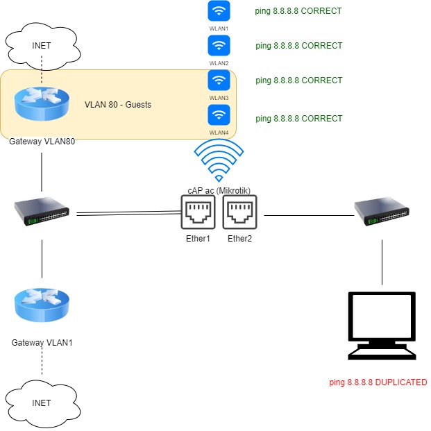

But, when I migrate cAP to production environment, Linux machines shows duplicated pings :frowning:
Where are the Linux machines connected?
Where from are you pinging them?
What is you production environment layout?
I can guess, that the problem lies somewhere else, not on the cAP.
But too little information for anything more specific. :slight_smile:
I think the same, but the problem is on cAP, I try to do same test on non-production environment, no good results.
Duplicated pings are produced when I connect a Linux host on ether 2.
If I connect same host on wlan 1,2,3 or 4 answers are not duplicated. Only via ethernet cable.
Where from do your ping it?
And what is connected to ether 1 at this time?
Check how many icmp packets to 8.8.8.8 are actually leaving cAP on eth1 and how many are returning.
I still tend to blame the switch on the left for that behaviour.
