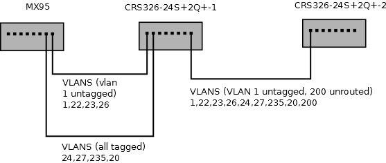

VLAN Issue
I’m in the middle of swapping out all the switches at work and I’m having an issue I do not understand.my main CRS326-24S+2Q+ is able to access all VLAN gateways. But any switch connected to it is not able to access any VLAN gateway but my management gateway. If I don’t add a route I get “no route to host” which makes sense. But if I a route to one of the gateway IPs I get timeout or host unreachable responses. The gateway IPs are all hosted on a Meraki MX95 and by default it allows routing between all VLANs. The VLANs I am testing have not been blocked from my management VLAN.
Here is the config for my main CRS326-24S+2Q+

And the config for my CRS326-24S+2Q+ that is our production top of rack switch

Here is a very basic diagram with only the CRS326-24S+2Q+s shown. Once I figure out the issue with CRS326-24S+2Q±2 I should be able to easily apply the solution to the CRS328-24P-4S+s I’m deploying. The link between the CRS326-24S+2Q+s is an 802.3ad bond on the QSFP+ ports.
Are you sure about that, the /interface bridge vlan and /ip address configuration is likely wrong.
Under /interface bridge vlan you should specify tagged membership for all the interfaces which you are expecting switched VLAN traffic to pass through. In this context bridge is an intrinsic switch port connecting the bridge to services on the Mikrotik - you only need to include it for VLANs which you wish to access on the Mikrotik itself, not those which are merely being switched by the Mikrotik, see http://forum.mikrotik.com/t/routeros-bridge-mysteries-explained/147832/1
For any bridge VLANs with tagged=bridgename you also require an /interface vlan to which an IP address can be added for access to/from resources on the Mikrotik itself.
With parallel connections with differing VLANs between devices the default RSTP on the Mikrotik will block one of the links, if you do not have the same VLAN on both you can disable spanning tree, otherwise it requires MSTP configuring.
As i can see you use untaged VLAN for your Management access…
Generally you don’t need to add the bridge as Tagged port for every VLAN unless that is your Router or you want to create Management access for that VLAN…
Finally, i can see no other VLAN added as tagged for any VID so that it can pass the Trunk port of your switch …
Take a look here Using RouterOS to VLAN your network
Once I added the ports & bonds as tagged items for the VLANs it worked. The only other weird thing I’m seeing is that with LACP enabled for links between switches I tend to get connection glitches in things like vSphere remote consoles. Known issue or a probably miss config on my part?
