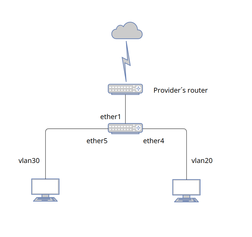

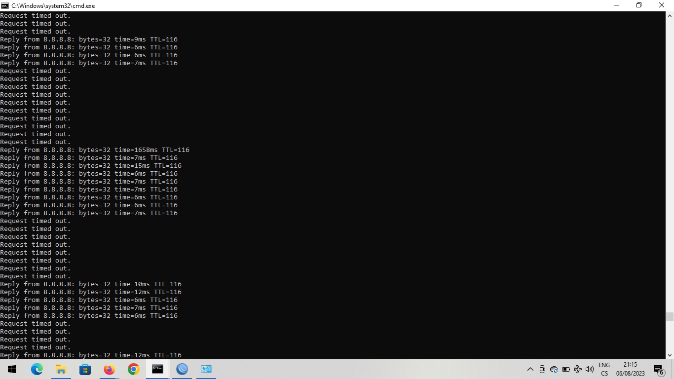

I have starrted fresh new Mikrotik RBD52G-5HacD2HnD-TC, without any changes to the original firewall settings my goal was to create two VLANs (id20 and id30) to connect two computers. I have used wiki as resource and created VLANs and connected computers. My problem is, that every few seconds both computers losing access to the WAN and I am not able to find out why…
full config attached and PING showing drops also with topology schema - very basic
