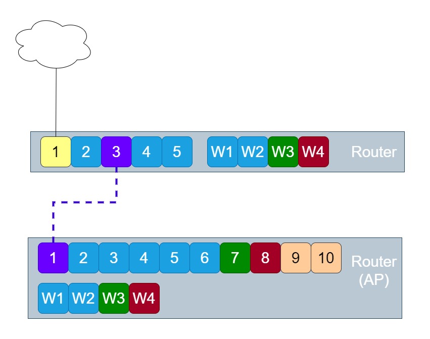

This should illustrate what I am trying to set up.
Yellow: WAN
Orange: MGMT VLAN (99)
Blue: HOME VLAN (10)
Green: Guest VLAN (20)
Red: IOT VLAN (30)
Purple: TRUNK Port

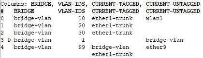

VLAN tagging on main router:
VLAN tagging on ap router:

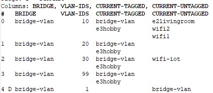

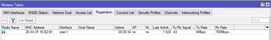

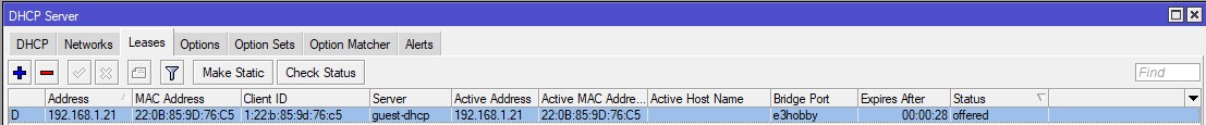

When I’m connecting to the wireless interface I can see a registration and on the main router a offered dhcp lease.
Wifi directly on my main router works well.
(I just see, that I messed up the images and the registration is not aligning with the corresponding dhcp lease offer. But still this happening)

So the AX3 is your main router and the RB4011 is WHAT? Supposed to be a AP/Switch or another router ( do you really want double NAT )???
The RB4011 should not be used as a router. I called it a “router” because it is sold as a router, but I just want to use it as a Dumb AP/Switch to have the Ethernet ports and multiple wireless interfaces available and append them to my VLAN configuration to communicate with the AX3.
Okay so you want it as a dumb switch which tells me you only have one subnet coming into it and its feeding a bunch of dumb devices on one subnet.
In other words, as always I never trust what people say/write, I only go by the evidence
and your diagrams and config support the fact that the RB4011 is indeed carrying multiple vlans and thus is acting like a SMART AP/Switch.! :slight_smile:

With this bridge vlan tagging it’s still working for vlan10, vlan30 and vlan99.
Clients which are connected to vlan-20-guest does not get an ip address back if the bridge is not tagged but the lease is offered on the main router.
I left the bridge tagging in place to give clients on these vlans an ip address, and used the guest vlan to test if any changes would make it work.

(1) Now I have removed the bridge vlan from vlan10 and vlan30. I know this should be the correct configuration, but I can’t get an IP address if I don’t tag them.
/interface bridge vlan
add bridge=bridge-vlan tagged=ether1-trunk untagged=wifi1,wifi2,ether2-pc,ether3-dockingstation,ether4-nas,ether5-laptop,ether6,ether9 vlan-ids=10
add bridge=bridge-vlan tagged=ether1-trunk untagged=wifi-guest,ether7-guest vlan-ids=20
add bridge=bridge-vlan tagged=ether1-trunk untagged=wifi-iot,ether8-iot vlan-ids=30
add bridge=bridge-vlan tagged=ether1-trunk,bridge-vlan untagged=ether10-mgmt vlan-ids=99

With the current upload (ap.rsc), I’m only getting IP addresses if I’m connected through an Ethernet port. All wireless interfaces are not resolving. However, I can see on the router that the dhcp server has been requested to provide an address.
home-dhcp offering lease 192.168.0.236 for D2:3C:05:FC:73:F6 without success

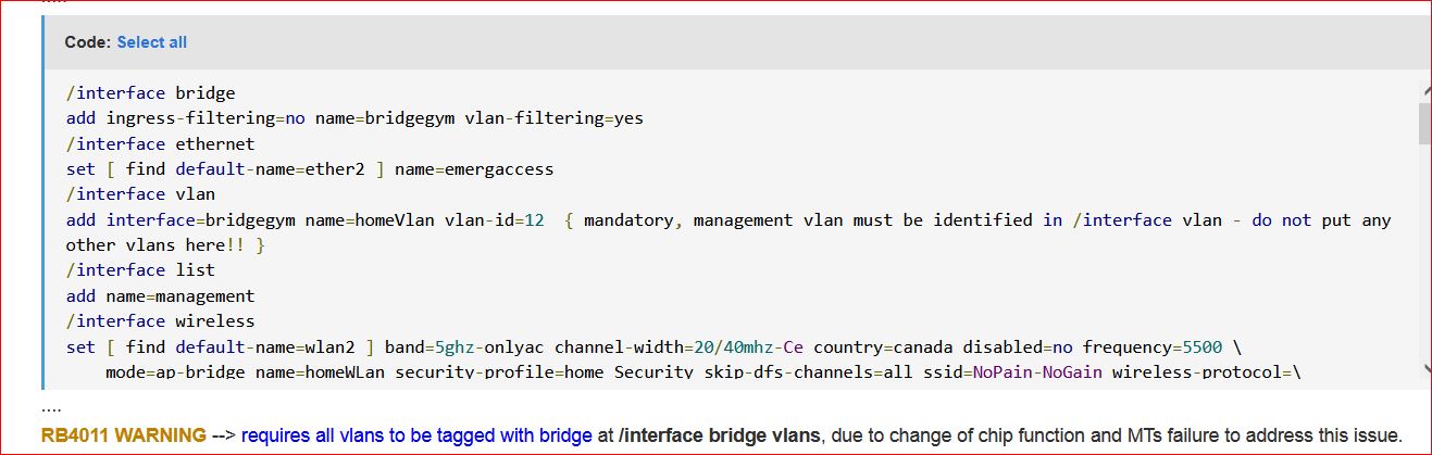

One bug on devices that can offload VLANs to swtich chips (and RB4011 is one of them) on one and and have more than one switch chip (RB4011 is one of them) on the other hand: if VLANs span anything but single switch chip, then bridge port has to be tagged member of that VLAN even if device does not have to interact with that traffic on IP level. In your particular case this affects both traffic between ether ports managed by different switch chips (ether1-5 and ether6-10) as well as any wireless traffic.
So add “bridge-vlan” as tagged port to all relevant VLANs under /interface/bridge/vlan.
Wait, so you are saying that both switch chips need the bridge to be tagged for every vlan??
and what does switch chip have to do with WIFI Bridge ports ur killen me…
In that case, it explains why the OP had success tagging when it seemed illogical.
MKX I could kiss you, well you know what I mean, metaphorically and no tongue!!!
It’s been explained that when they first implemented L2 HW offload, they implemented it so that CPU-switch interconnect will only pass VLANs of which bridge interface is member (either tagged or untagged). And it worked perfectly because those devices were wired-only devices with single switch chip (i.e. CRS3xx).
The concept hit the wall with enabling HW offload on RB4011 which has two switch chips (and wireless). And CPU-switch interconnect carries more than only traffic between ROS (the L3 entity) and the rest of network, it also carries traffic passing between ethernet ports on different switch chips or traffic between wireless interfaces and ethernet ports.
I think MT promised to think about it, but currently the official solution is to work around it by declaring bridge as tagged (or untagged) member of all VLANs which have to break out of single switch chip.
Okay but only for RB4011 correct.
My apologies to the OP. This should work.

Well, OP’s ap.rsc mentions it’s from RB4011 … hence my post is highly relevant in this thread.
Yes, but it was not in my applicable useful article yet AP SWITCH SETUP, so it couldnt be true. Now that its added, I believe you. ;-PP
@anav @mkx
Thank you for helping me understand why it worked the way it did. I just wanted to check that I hadn’t done something completely wrong.
