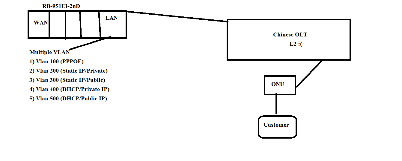

Need some help regarding a situation. Recently we got a OLT which we are testing. I have tried many way to make it work with vlan. But the OLT it self is a L2 device which made it hard to work with. Any IP assigned to the vlan interface don’t work. I tried bridging the interface but it dont work either. Any one have any other thoughts how we can make it work.We want the customer to receive their respective vlan’s IP with the OLT that we are testing.The olt cannot recognize the vlan from Mikrotik .Any suggestion will be highly appreciated. The Mikrotik we are using is only for testing. We are planning to use CCR1036 once we finish our testing.Thanks

Maybe i didn’t clarify my requirements. The model we are using is only a 2pon OLT. Maybe you used a 4 PON model which may have this function But in 2pon we cannot make it work.We don’t want the onu to be under a VLAN at present.Maybe in future when the network grows we may want to manage the onu by a assigned vlan for management purposes. At present we want the clients CPE (router/pc/anything) to be managed via a vlan that has been created on Mikrotik. And we cannot make it work. Any idea or any sort of remote help will be highly appreciated. Current situation Mikrotik–> OLT → ONU–> Customer Equipment (we want it to be under a vlan from the mikrotik). Thanks

This is the actual config..
[admin@OLT-MT] > ip add print
ADDRESS NETWORK INTERFACE
0 192.168.10.254/24 192.168.10.0 bridge1
1 192.168.50.254/24 192.168.50.0 vlan200-Static(Private)
2 ;;; ==For VLAN 300==Not work==
192.168.60.254/24 192.168.60.0 vlan300-Static(public)
3 D 172.16.100.241/32 172.16.100.242 pppoe-out1
/interface vlan
add interface=ether4-LAN name=vlan100-PPPOE use-service-tag=yes vlan-id=100
add interface=ether4-LAN name="vlan200-Static(Private)" use-service-tag=yes
vlan-id=200
add interface=ether4-LAN name="vlan300-Static(public)" use-service-tag=yes
vlan-id=300
add name=bridge-trunk
add name=bridge1
add bridge=bridge1 interface=wlan1
add bridge=bridge-trunk interface="vlan300-Static(public)"
add bridge=bridge-trunk interface="vlan200-Static(Private)"
add bridge=bridge-trunk interface=vlan100-PPPOE
/interface bridge settings
set allow-fast-path=no use-ip-firewall=yes
Maybe i am missing something in this. As far i know if we create multiple vlan on a Mikrotik interface that interface becomes trunk. so i think the olt should be in access mode. i am confusing myself in this maybe..any chances of getting some remote help in this. thanks

I am using both CLI and EMS that they have provided. I have configured the vlan via ems. But it doesn’t work. Now I am wondering if the Mikrotik cannot read the vlan tag when i connect the customer device directly to the Mikrotik without using OLT and ONU, If i use a manageable switch it will solves the problem. But i am curious how to make the Mikrotik works with vlan when there is no manageable switch?? Any thoughts on that??

They way a see it your MK connects to the olt via ether 4 (this should be a trunk).
Now the OLT is basically a switch so…
-Replace the olt with a vlan capable switch.
-Trunk the switch interface that connects to the MK (lets say port 1)
-Configure port 2 of the switch as an access port (tag the customer vlan you want it in)
-Plug th CPE on port 2.
If that works the problem is on the OLTs side.
If not… you still have a pronlem with the MK config.
Hope it helps…
