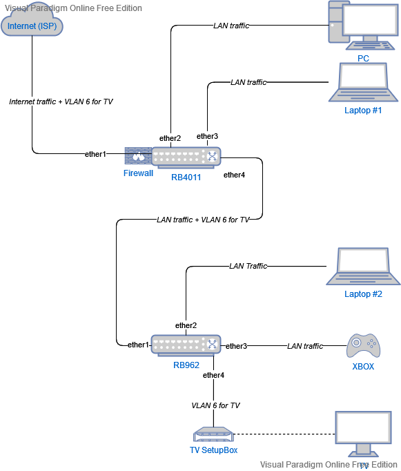

I have faced with the problem how to pass-through VLAN from ISP to internal Mikrotik (RB962) via new RB4011iGS+5HacQ2HnD-IN (diagram attached).
In my previous setup I have used RB2011 with VLAN filtering capable Switch chip. As per Mikrotik the new RB4011 should be able to do the same task using Bridge functionality.
Migration to new RB4011 went smoothly except VLAN part - have no ideas how to setup it.
VLAN used for IPTV traffic. It comes from ISP trunk port and gives IP for SetupBox via DHCP Client (DHCP server on ISP side).
My best attempt on RB4011 enables LAN and internet access on both routers, but no success with VLAN (standard parts were skipped):

Simplified config on RB962 (worked successfully in pair with RB2011, therefore I didn’t changed it):
# RouterOS 6.46.4
# model = RouterBOARD 962UiGS-5HacT2HnT
add comment="Bridge for local LAN (TV excluded)" name=bridge_local
set [ find default-name=ether1 ] comment="Port to RB4011 (main router)"
set [ find default-name=ether2 ] comment="Laptop2"
set [ find default-name=ether3 ] comment="XBox "
set [ find default-name=ether4 ] comment="TV SetupBox"
set 0 vlan-mode=fallback
set 3 default-vlan-id=6 vlan-mode=check
/interface ethernet switch vlan
add independent-learning=no ports=ether1,ether4 switch=switch1 vlan-id=6
add bridge=bridge_local interface=ether1
add bridge=bridge_local interface=ether2
add bridge=bridge_local interface=ether3
Any help or advice would be appreciated.
