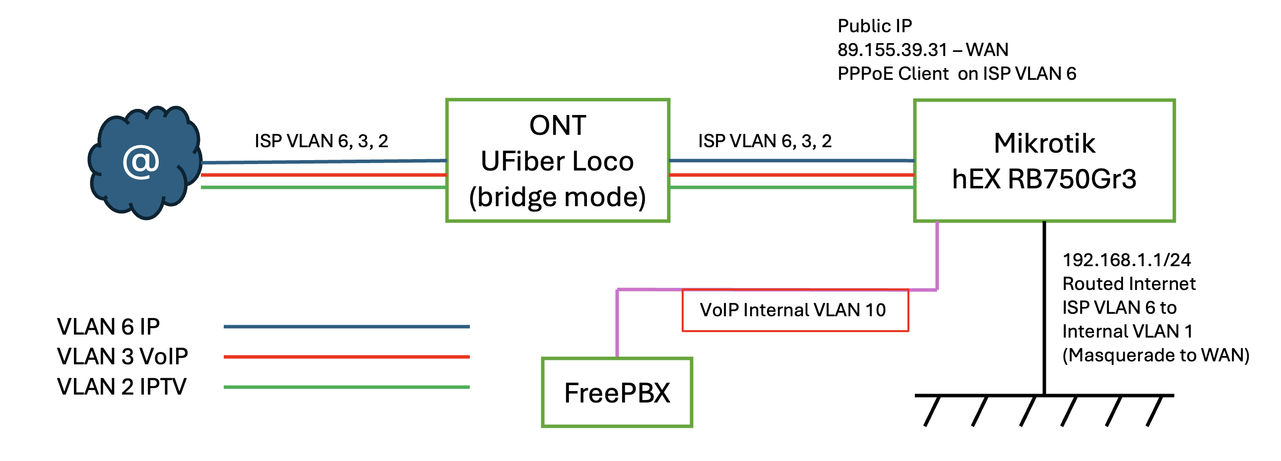

I’ve got an fiber connection with my ISP that offers IP, VoIP and IPTV services. My setup is as follows.
The fiber connection receives 3 different VLANS: 6 for IP services, 3 for VoIP services and 2 for IPTV services. I’ve got a UFiber Loco that takes in the Fiber connection and converts to Ethernet, in bridge mode, so that the router will manage all addressing. So, it sends all VLAN tagged packets to the router transparently.

Now, my idea is to make this network more secure and segmented. What I want to do, as shown in the attached picture, is to kind of passthrough/bridge the ISP VLAN 3 to my FreePBX machine, maybe to another VLAN ID. So, basically I want to:
  • Not configure a DHCP client on the router for the ISP VoIP VLAN, so I won’t have any address set in the router
  • Make that the FreePBX machine DHCP client gets its IP address directly from the ISP DHCP server on the VoIP VLAN.
So basically, the question is how to configure the router to not route the VoIP traffic and allow the FreePBX machine direct access to the ISP VoIP VLAN 3.
