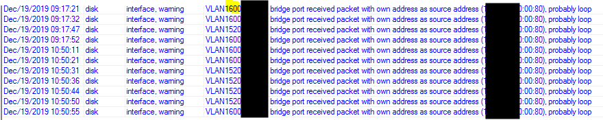

On core router CCR1009-8G-1S-1S+ I get every 12 hours or so vlan error messages, I have checked the paths of the vlans listed but unable to locate the fault,
Is there any general guidelines in fault finding a issue like this?

This info on the core logs only appeared when I updated almost all the network to 6.45.7 + Interface port Isolation + Bridge port PVID “Ingress filtering” “admit only VLAN tagged”

On a update to the error messages, I have been applying VLAN filtering to CPE’s + AP’s + PTP and this was when the error messages appeared at the core router,
I have all my PPPoE VLAN’s on one interface (Ether5) , is it possible to VLAN filter at the core router!
