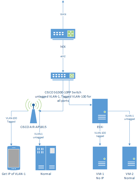

After 6.41, master port changed to bridge, I find my vlan does not work as intended.
Some vlan-100 clients get vlan-1 IPs, some didn’t get any IP.
My network topology is as follows:
hEX config related with VLAN as follows:

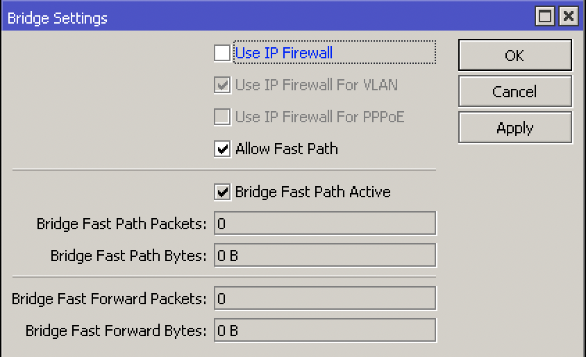

(1) My advice besides posting the complete config as noted above is to remove this rule
/interface bridge settings
set use-ip-firewall=yes use-ip-firewall-for-vlan=yes
as its very tricky to use properly and is only needed in special cases whereas the normal firewall rules work for 99% of needs.

(5) only two devices connected to hEX directly, eth1 connects to fiber modem, eth2 connects to CISCO Switch.

What are your reasons to use use-ip-firewall-for-vlan=yes under /interface bridge settings? Can you change that to no and try again?
There is no perticular reason.
I have set it to no now.

So, I am wondering if my CISCO AP has some bug?
I have found out what is wrong.
I have set native vlan of AP to 100, so even if I set “use tag”, it won’t be tagged.
It is working right now.
