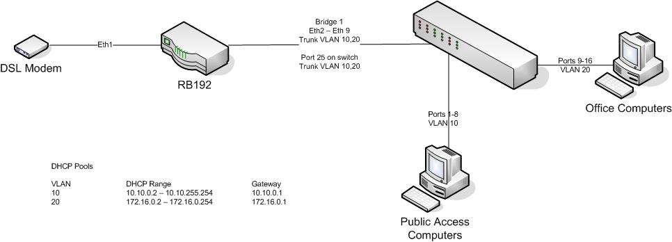

I think that we need to see network topology diagram to make any advices.
Please see attached. Its a fairly basic topo.
Why do you need bridge for all interfaces ?
I guess it’s enough to create VLAN on the interface, which is connected to the switch, then setup DHCP servers on VLAN interfaces.
