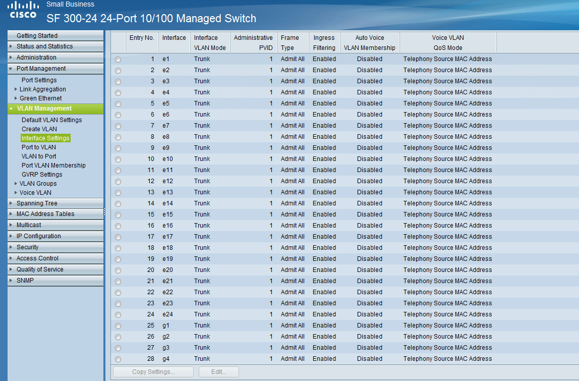

default switch config as in screens

So you created a trunk port on the Cisco, but did you tell it what VLANs are allowed on it? If it doesn’t know what VLANs are allowed it will just drop the packets that are tagged, since it won’t know what to do with them. You will also need to have a trunk port to the central router, otherwise the router has no way of getting back to the access points.

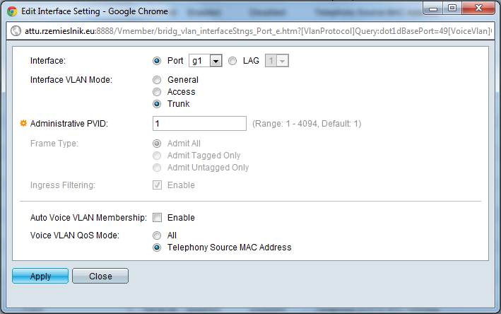

so I have to change values on first switch on my preffered ports to “admit all” ? or switch port to general?
Like I said, I don’t own one or use one of those switches, I have no idea what specific steps you need to take to configure it.
What you need to do is set up a trunk port on the switch and tell it to listen for certain tagged VLANs, in your case 10-50 if that’s what you have setup on the access point router. Then with the uplink port to your router you need a similar port, it needs to send packets that come in on lets say ether1 with vlan10 out of ether24 (your router’s LAN) tagged with vlan10. Your router also needs to know to listen and look for those VLANs.
