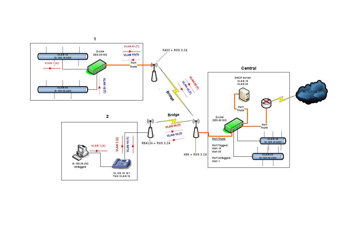

Hi there;
sorry for reopen the POST but my customer haven’t find a solution and with the informacion that you have give me also i’m in doubt.
The problem is from 2 to Central.
With RB411A i want to tag traffic untagged that generate the pc with ip 10.158.50.202/24. Traffic from the telephone is already tagged from the same IPTel [VLAN10].
With RB411A i want to “translate” untagged traffic [VLAN1] in VLAN50. This is my configuracion:

But traffic arrive to the switch D-link DES-3010G untagged [traffic from VLAN10 is OK].

bridging vlan interface with physical interface where vlan is added will not work.
It doesn’t work. VLAN 50 doesn’t arrive to central. Anyone can tell me how can i do it?
Thank you in advance.
Best Regards.
Just create Virtual AP interface instead WLAN interface and put it int the bridge :
instead:
add bridge=“VCA-Cementerio” interface=wlan1
put:
add bridge=“VCA-Cementerio” interface=virtualAP-wlan1
Regards,
Ilija
