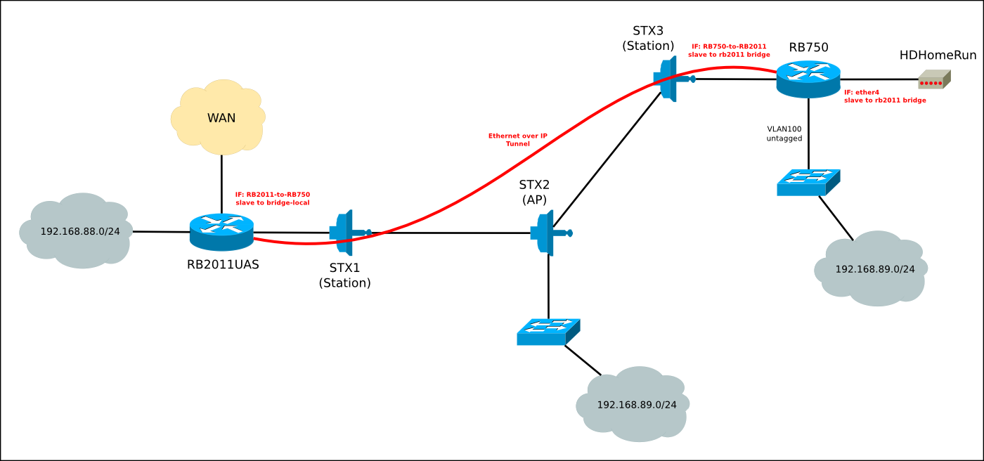

I think the way of least resistance would be to leave your current setup as-is, insert an RB750 at the remote site as suggested above and create a EoIP tunnel between the remote RB750 and the locally kept RB2011. On the RB750 create a bridge and assign the EoIP interface as a slave/port. On the RB2011 assign the EoIP interface to the bridge-local bridge. That bridge is part of the default configuration which I assume is partially still in place.
jayd2k: Thanks for the suggestion. I’ll try it. (Nice diagram, by the way. Exactly correct.)

You could still use an EoIP tunnel between RB2011 and RB750 (at STX3) as described earlier.
Actually, I think that the EOIP tunnel needs to go from the RB2011 to the RB750, not the STX3. Thanks again for the advice.
