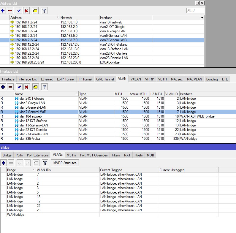

Hi All,
I’ve configured an RB5009 with some VLAN, now I’ve 2 host; 1 in vlan 5 with IP Address 192.168.5.11 and one in Vlan 7 with IP 192.168.7.112, but from Vlan 7 I can’t ping host in vlan 5, anyone can help me, please?
mio.rsc (12.1 KB)

Hi
@anav: Thank a lot but is not a problem, I’ve a LOCAL bridge on ether2 with spcific DHCP and IP Address and I can reach the RB5009
@BartoszP: I already read it, now I’ve a varous VLAN on my RB5009 like the screen, the port ether4 is connected on Cisco Switch with port in Trunk, allowed vlan 2,3,5,7,12,13,22,23
Now with PC connected on Cisco Sw on access port vlan 7 with IP 192.168.7.100 I can’t ping ping RB5009 on 192.168.7.2, I can’t understand why…
Most likely firewall rules.
Check that referenced thread again.
if you want help post the config not snippets or jpegs
/export file=anynamwyouwish ( minus router serial number, any public WANIP information, keys etc. )
If you did indeed read the linked article than you would not have four (4)! bridges on your RB5009UG+S+, instead only one (maximum two if you followed Kentzo’s guide on how to dynamically update NPTv6 firewall rules). For more details see the Switch Chip Features part of the documentation. The features and limitations of 88E6393X are relevant for you, and in the VLAN Table section you’ll see the note that “Devices with MT7621, MT7531, RTL8367, 88E6393X, 88E6191X, 88E6190 switch chips support HW offloaded vlan-filtering in RouterOS v7. VLAN-related configuration on the “/interface ethernet switch” menu is not available.” Therefore except of the two ports which are used for Internet access (WAN ports) should be included in the single bridge (which supports hardware offloading features). @Anav given you the advice in order to avoid locking out yourselves from the router. Unless you have a 10 GbE Internet connection dedicate ether1 and ether2 for Internet uplink and use sfp-sfpplus1 as a link to your core switch (if it has SFP+ slot).
Therefore an example starting bridge configuration:

Hi at all,
I changed the config and I remove some bridge that isn’t in production
I set the correct routes like 0.0.0.0/0 to 192.168.1.254 (my provider router) and other one 192.168.0.0/16 to my RB router, and now all works fine
Thanks for all your support!!!
Stefano
