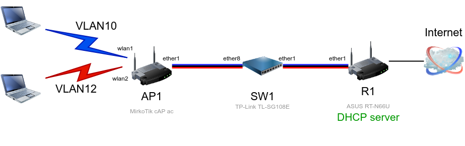

The setup is:
router (ASUS RT-N66U with Tomato firmware) <===> switch (TP-Link TL-SG108E) <===> AP (MikroTik cAP ac)
Note: in my initial description I used VLAN ID 10 and 20, while in the actual (current) setup I use 10 and 11 (will probably change it when things settle - the ID’s in themselves are not that relevant for the problem at hand). But, to stay on the same page, for now let’s use 10 and 11(as you will see, there are also: 1 and 12).

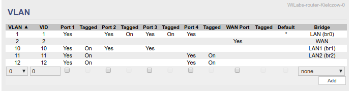

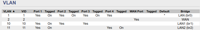

@router
A screenshot of the VLAN config included in the attachement. The config has not been changed. I don’t intend to change that unless necessary.

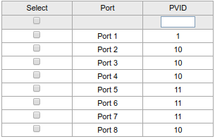

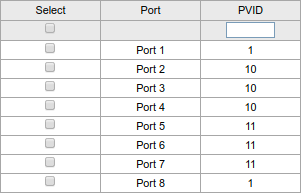

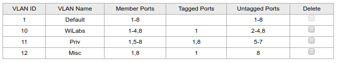

@switch
While working on the setup, I play around with 802.1Q VLAN Configuration section, so this may have changed from my initial description (i.e. tagged/untagged ports for VLAN 1, 10 and 11).
The port 8 of the switch is the port connected to AP, while the rounter is on Port 1. The rest of the ports are used by other equipment in my network, but I guess this is not relevant for this setup. A screenshot (of the current config) included.
LAN PVID setttings:
Port 1: 1, Port 8: 10

Should I add vlan-filtering=yes in /interface bridge (as indicated in https://wiki.mikrotik.com/wiki/Manual:VLANs_on_Wireless)?
Anything else I am missing?
What should be the correct cAP configuration for RouterOS version 6.44 and this setup?
I’ll continue to experiment, but any suggestions to point me in the right direction would be most welcomed!

If the screenshot of switch config is current, then you have a mess there. Example: port 8 is set as untagged member of multiple VLANs. That just can’t work right … if port 8 is indeed used to connect cAP ac, then it has to be tagged for VIDs 10 and 12.
MKX is usually correct! I see nothing wrong with your capac config.
Post your switch settings if you can…
OK, so let’s have a look at other network elements.
@router:
@switch:
Note: VLAN ID 12 is now replaced by VLAN 11, also at cAP;
(so we now have VLAN 10 and VLAN 11, instead of VLAN10 and VLAN12)
Observations:
  • I’m able to access cAP via its ether1 (so I get access to WebFig via wire)
  • I’m able to connect to cAP via wifi (wlan1 or wlan2) and obtain IP address (always from VLAN 10 DHCP pool), no Internet access though
  • If I change Port8@SW1 to “untagged” for VLAN 10, I get the Internet access when connected to cAP via wlan1 or wlan2 (but IP remains from VLAN10 DHCP pool, no matter if connected via wlan1 or wlan2)
Does it make any sense…?
My guess is that your TPLINK switch is not setup correctly.
Clearly
port8 is a trunk port that requires tagged 10,11
Port1 is a trunk port that requires tagged 10,11
The only other ports that require tagging of vlans 10,11 would be other trunk ports on the switch.
The only other ports that require untagging of vlans 10,11 would be access ports (to devices on the vlans that cannot assign vlans themselves like pcs or printers)
I would suggest deleting vlan=1 but if you cannot DONT TAG OR UNTAG any ports. You may just have to leave the setting of member of ports 1-8.
Port 8 GET RID OF PVID setting. There should be none its a trunk port.
Port 1 GET RID OF PVID setting. There should be none its a trunk port.
I gather ports 2-4 go to devices on vlan10 that are described above, pcs or printers on vlan10 right??
I gather ports 5-7 go to devices on vlan11 that are described above, pcs or printers on vlan11 right??
Thanks for all the explanations! :slight_smile:
What I’ve tried to do/clean in the meantime:
  • make “tagged” ports for trunk ports only
  • make “untagged” ports used for vlan-unaware equipment (no trunk ports)
Here is the updated setup (which seems to work!)
@switch
  • changed port tagging: tagged only trunk ports (1,8), rest is left untagged (@anav: yes, they’re used for other devices in both vlan10 and vlan11, respectively)
  • could not delete vlan1 (delete is dissabled for vlan1)
  • set port8 as “non member” for vlan1 (the options are: untagged / tagged / not member), tagged member of vlan10 and vlan11
  • it’s not possible not to assign any PVID to a port (no such option), so I assigned PVID 1 to Port8
