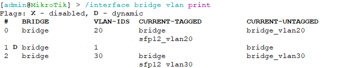

I know that, but can you tell me if I have bridge with multiple vlans in it (see attachments) - bridge vlan have to be trunked on bridge itself or not ? For the access/trunking ports/interfaces its clear for me.
ad4)
please check attachments

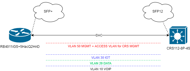

Provide a network diagram that at least shows the ports being used to connect the devices and what vlans are flowing through them etc.
Also a full config /export minus any wanip info or serial number.

Network diagram:
All i want is to get ip address on each vlan on switch from rb4011 DHCP
Currently on above config I cannot obtain on CRS ip on vlan 20 and 30 simultanously.
