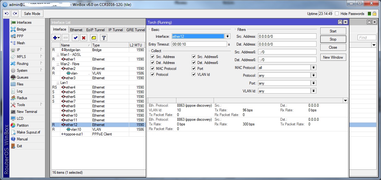

I am seeing something similar in RoS6.0 on a CCR1016
I have a VLAN 10 configured on ether12 and with a pppoe-client configured to use VLAN 10.
Torch shows the tagged outgoing pppoe-discovery(8863) packets (vlan10) and shows the replies have no vlan tag. (This is the actual issue I am trying to diagnose)

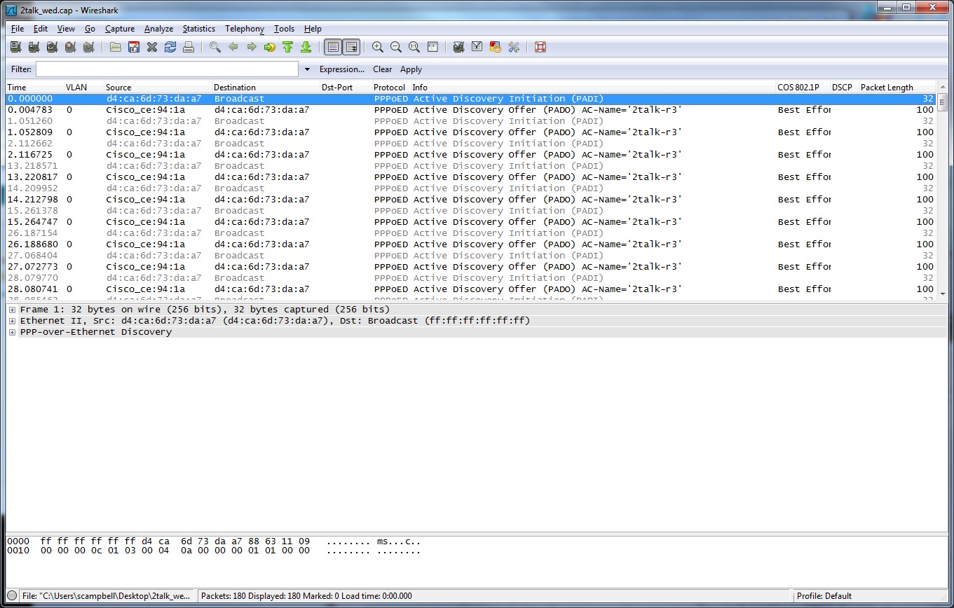

When I do a packet sniffer on ether12 and look at the packets in RoS6 it shows vlan10 yet when I view the file in Wireshark the outgoing tags are missing in the trace.
