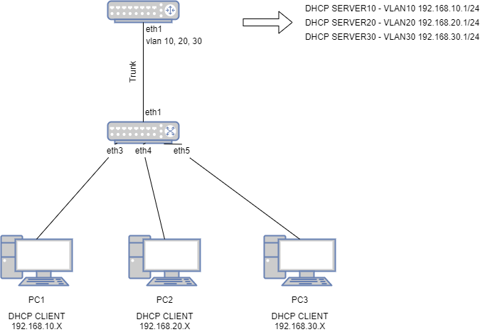

i have the following scenario (see attachment)
simple. I use 2 Routerboard RB750Gr3, my first one have one ethernet in trunk (vlan 10,20,30), each vlan has an IP address and one DHCP Server on it.
i would like to configure my second RB as a switch to give tag or untag on some ethernet ports.
in my case, eth1 is my trunk, and on eth3 wonna connect a PC1 (in DHCP) and expect to have something 192.168.10.x on eth4 something with 192.168.20.x
very linear. I follow this: RouterOS - RouterOS - MikroTik Documentation but without success

If you check the same document you quoted, but top most section (introduction), you’ll see that hEXGr3 doesn’t support VLANs in hardware. Hence your config, even though it might seem to be accepted, doesn’t really work. You’ll have to configure VLANs on bridge (follow this tutorial, post Switch with a separate router (RoaS)) … but you’ll loose HW offload unfortunately.
BTW: just pointing out the obvious: R1 doesn’t have any firewall setup, hence it’s not suitable to expose it to internet.
Read this reference, will clear it up for you!
