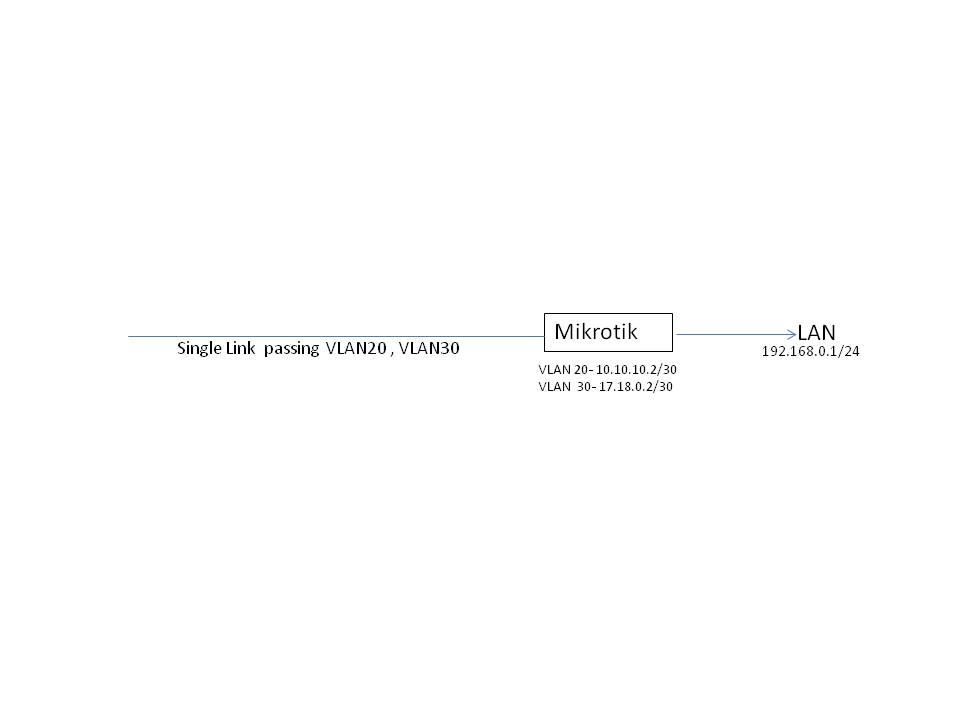

i want to configure multiple VLANs on Mikrotik.
One link is coming to Mikrotik with multiple VLAN.
how can i tag VLANs on Mikrotik router.
please see attached
regards
Hi All,
please see attached
regards
Create VLAN interfaces on the ethernet port, with the required vlan IDs
hi nick,
i tried, but only one VLAN is working
please assist
Let assume that your incoming interface called ether1. Then you need:
/interface vlan add disabled=no vlan-id=20 interface=ether1 name=vlan20
/interface vlan add disabled=no vlan-id=30 interface=ether1 name=vlan30
If you put ether1 to the bridge you must specify that bridge as value of “interface” instead. If something is not working after this then check if vlans that coming to you is really properly configured.
