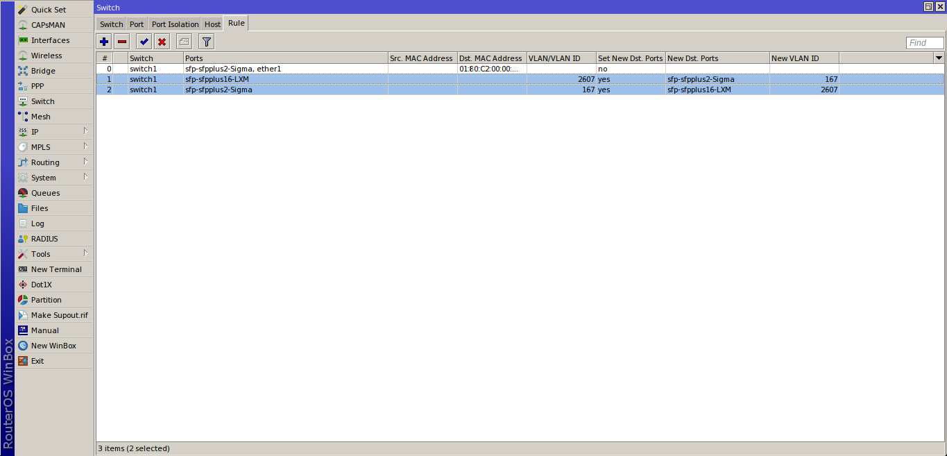

this is what i did now simple scenario

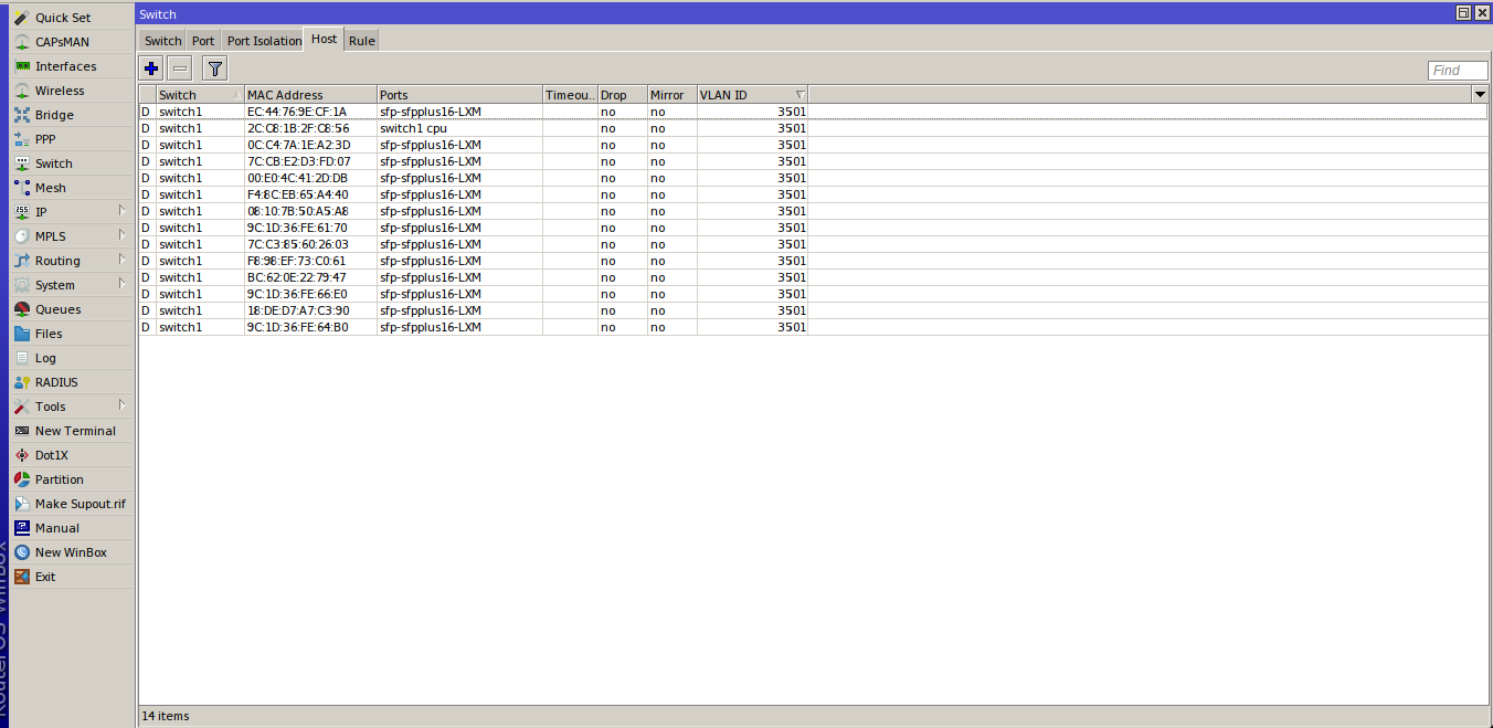

no mac address on sfp 2
and no mac of 2607 on uplink sfp 16

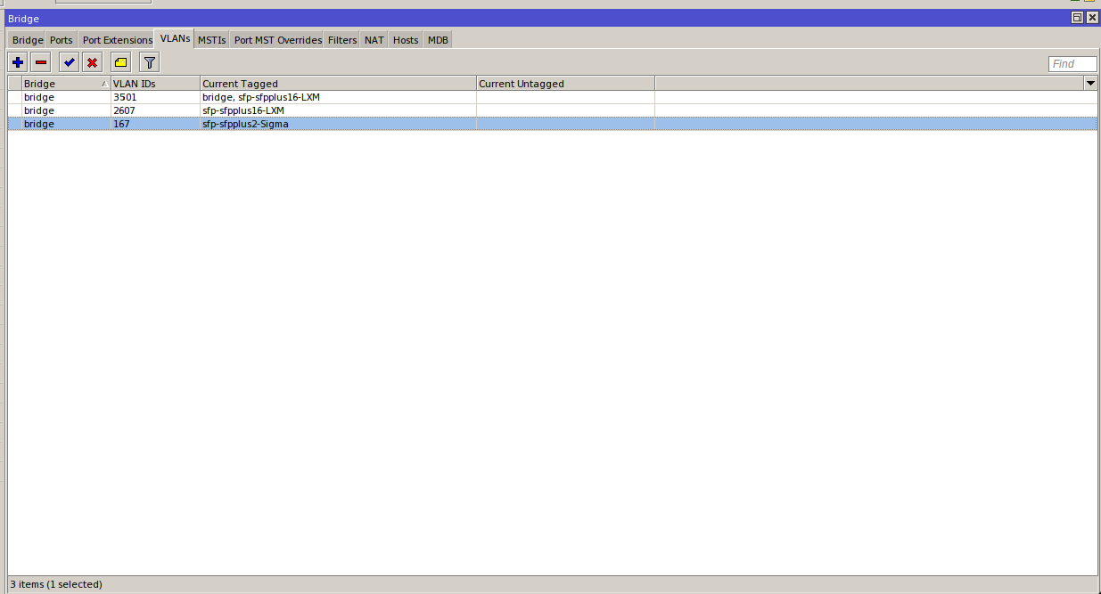

Are both vlans (167,2607) permitted under /interface bridge vlan? The thing is that on CRS3xx, most of the switch chip configuration is inherited from the bridge configuration.
ty
please find screenshot

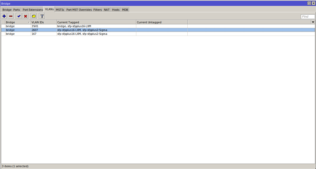

I would say permit both VLANs at both ports.
ty, done but still the same
