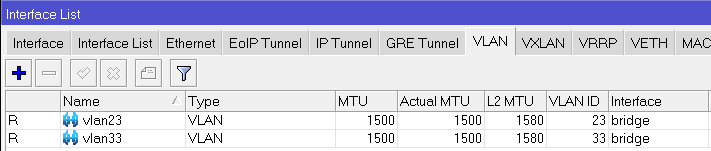

Thanks a lot, I’ve learned a lot thanks to you and everything works.
I can access the MiKroTik Switch from my VLAN33 (Clients) and from my VLAN23 (MGMT).
To do this, I had to add the two VLANs in Interface List / VLAN :
Is this bad practice?
I still have a mystery, I can’t ping my MiKroTik router or my Ubiquiti router when I’m connected to my switches (VLAN33), is this normal?
I’m trying to send a ping from my VLAN33 to equipment in VLAN23, logically my Firewall is correctly configured on my router (I can access the router administration interface locally from both VLANs), I imagine that there is a particular configuration on MiKroTik?
