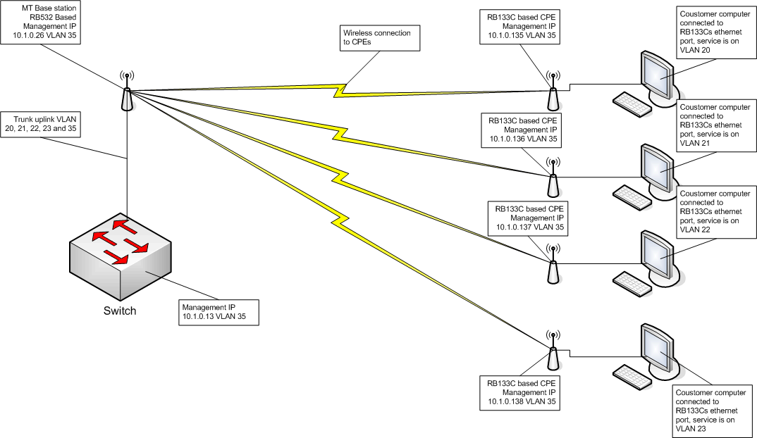

OK, I made a drawing of the setup.
As you can see the clients computers is connected to the ethernet port on the CPE or they have their private router connected. The ethernet port on the CPE needs to have static access to the VLAN the service that the client subscribes to is on, because the coutomers dont have VLAN capable equipment and I dont vant them to be able to connect to other VLANs. I.e VLAN 20 has 1500/300Kbps service, VLAN 21 has 4000/700Kbps service, VLAN 22 has some special service and so on.
I put all my equipment on a management VLAN that is only for that purpose, so I want to reach all equipment on that VLAN.
This make any sense?

There fore I made the drawing, so that you could see what cind of VLAN setup I was attempting.
Okay.. You could try this:
Put all the VLANS on the AP interface. On client you make static WDS and attach VLAN35 and VLANXX. Give management IP address to VLAN35 on client. Make Bridge on client with VLANIDXX. attach ETH1 to bridge Untagged.
