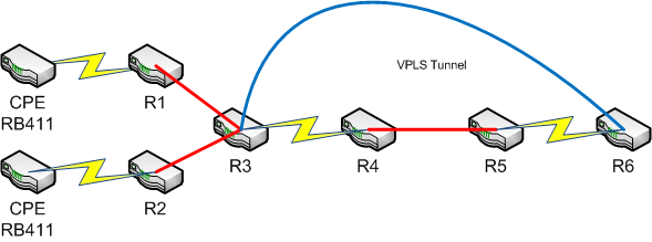

OK, help me understand fragmentation… will it be end-to-end, or just on the one ethernet link between R4 and R5?
If it is end-to-end fragmentation, how will this impact performance on the wireless links? Will there be a reduction in available bandwidth?
