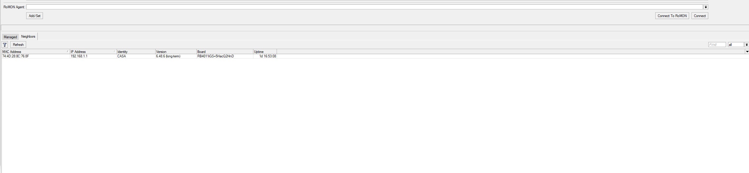

I dont see in winbox

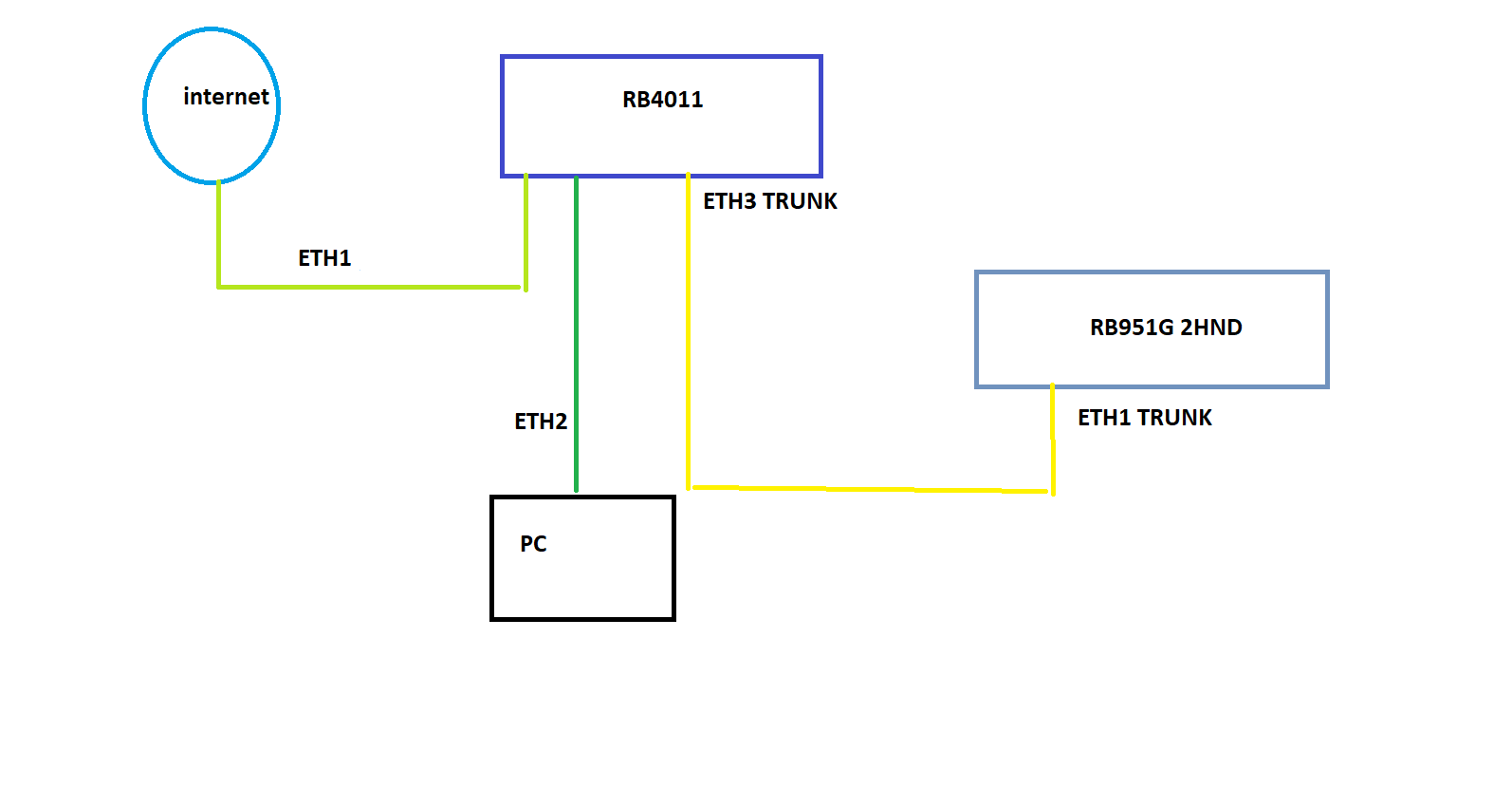

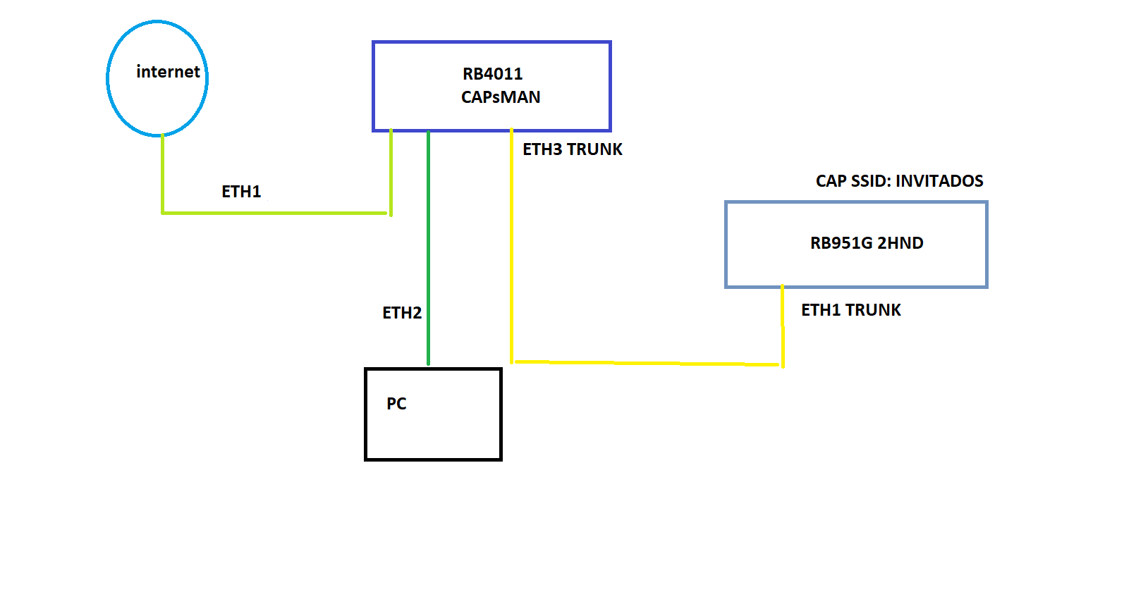

do u have second router?
Post config for both routers and please add a network diagram that shows internet connectivity, the ports on connected devices the subnets flowing through them.

(3) It is not clear the role of VLAN10 on ether3? You state its a trunk port on the RB but you config it like an access port, thus a confused setup.
The better question/answer is do you expect to have the LAN network on the RB951G device or ONLY vlan10 traffic?
(4) Why do you attempt to apply DHCP twice for vlan10 and different ones at that…
once on the RB4011 with subnt 192.168.200.0/24 and then on the second MT device again with subnet 192.168.10.0/24
On your network diagram you need to add all the ports being used on the RB400 and which traffic flows through the ports including the connection between the two devices.
It will then become clear what you have setup incorrectly. One only needs DHCP settings for a subnet in one location.
I am learning with the VLANs and I do tests watching youtube videos, it is normal that it is wrong.
I want to use RB951G as CAP with a VLAN that is my purpose.
Personally I would create as many vlans as needed and have NO subnet attached to the bridge, only vlans.

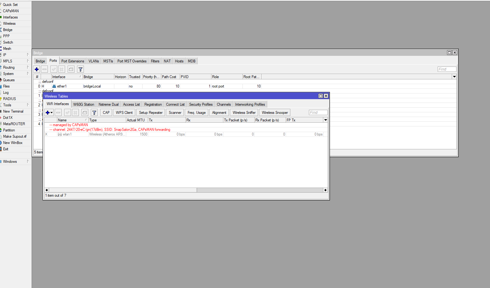

Now set RB95 default CAP Mode. I want to create a vlan on that cap.
aug/05/2022 13:06:00 by RouterOS 6.49
software id = 7DE5-ZHUJ
model = 951G-2HnD
serial number =
add admin-mac=E4:8D:8C:9F:6D:6A auto-mac=no comment=defconf name=bridgeLocal
/interface wireless
managed by CAPsMAN
channel: 2447/20-eC/gn(17dBm), SSID: SnapSalon2Ga, CAPsMAN forwarding
set [ find default-name=wlan1 ] ssid=MikroTik
add bridge=bridgeLocal comment=defconf interface=ether1
add bridge=bridgeLocal comment=defconf interface=ether2
add bridge=bridgeLocal comment=defconf interface=ether3
add bridge=bridgeLocal comment=defconf interface=ether4
add bridge=bridgeLocal comment=defconf interface=ether5
/interface wireless cap
set bridge=bridgeLocal discovery-interfaces=bridgeLocal enabled=yes
interfaces=wlan1
/ip dhcp-client
add comment=defconf disabled=no interface=bridgeLocal
/system clock
set time-zone-name=Atlantic/Canary
CAP RB95 already has a connection with CAPMAN where I created the vlan for CAPRB95

The only config item I am not sure of is one of the capsman settings where you referred to the Bridge.
I dont know if that should remain bridge or identify vlanCAP-10
The next post will detail the CAP config to match.
For this one the complete config is required… Again, take ether5 and configure it off the bridge as per the article, and then and do all your changes hooked up to ether5.
ACCESS POINT SWITCH CONFIG

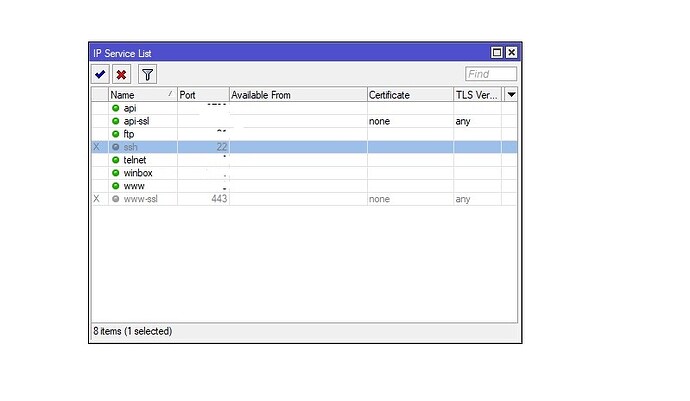

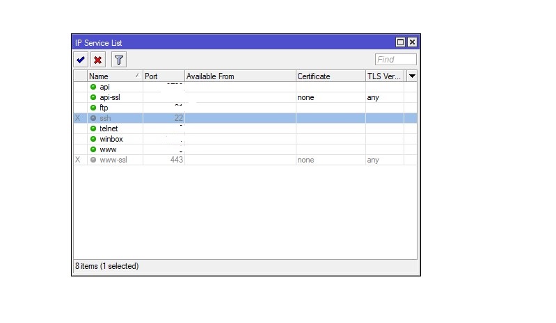

WARNING - Why is SSH setup without crypto, what is the purpose???
I don’t understand this I don’t use SSH.
What should I do?
Hi there…
Well not sure, as the stupid item was a default config along time ago.
Did you copy and paste older configs when putting on 6.48.6 ??
The best thing to do for now is to turn that off.
Go to in winbox SYSTEM, then Services, then ensure SSH is off NOT green. (hit the red X).
After some research on capsman, Its getting in the way of success, it gets complicated with vlans and hurts my head ( I avoid it like the plague )
Suggest get a working config with regular wifi settings first, then when its stable introduce capsman after some reading etc…
Unless of course you are a capsman whiz and this is no problem for you.
Is not the user wanted settings, are the default for v6.xx and when migrating to another version, where the new default are no / no, the export show that.
Also in CLI accessed via New Terminal you can type...............
/ip ssh set allow-none-crypto=no
Paste this on device for solve / align the new default
/ip ssh
set allow-none-crypto=no forwarding-enabled=no
