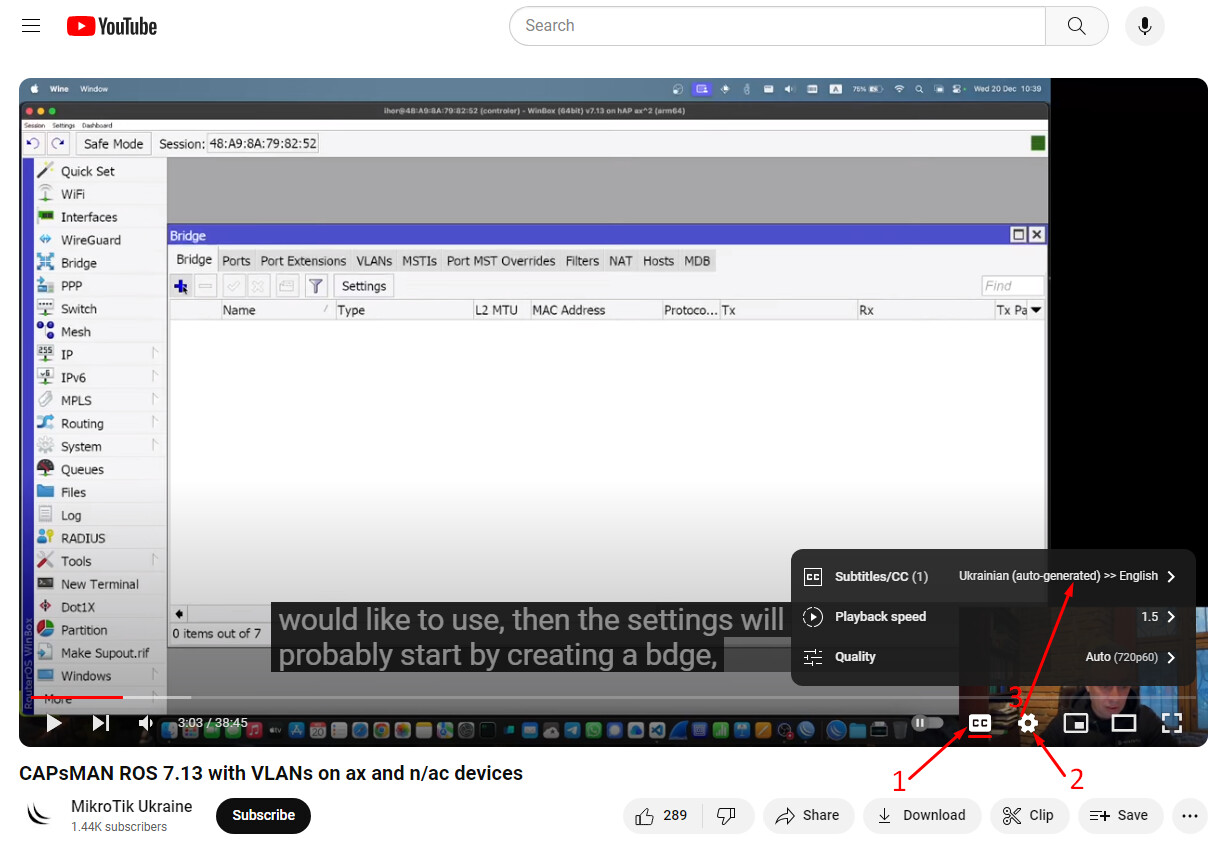

Also highly recommend you to watch this video with subtitles to be able to fully grasp the concept:
https://youtu.be/IUu_5wODp44?si=R_qJhYhIxAYSRHvG
Thank you, but I neither read nor speak Ukranian :frowning:
That’s why I suggested you using subtitles (forgot to mention with the option “Auto-translate” :slight_smile: )
Yeah, that option exists but causes no CC at all (for me, anyway).

I didn’t know there was an auto-translate feature until @TheCat12 mentioned it. To get it to work you must do several things: Turn on CC which will show in Ukranian, then in Settings, click on auto-translate and select language you want it translated to.
I did all that. Could be the ad-blocking in my browser that kills it – but frankly I can’t digest video tutorials even in languages I understand.
I use uBlock Origin and auto-translated subtitles works for me with Chrome on Win 10. Do you get subtitles in Ukranian if you don’t turn on auto-translate?
Having to read subtitles while also watching what is happening in the video is hard. At least you can rewind.
