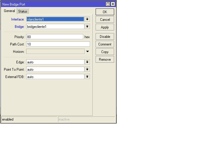

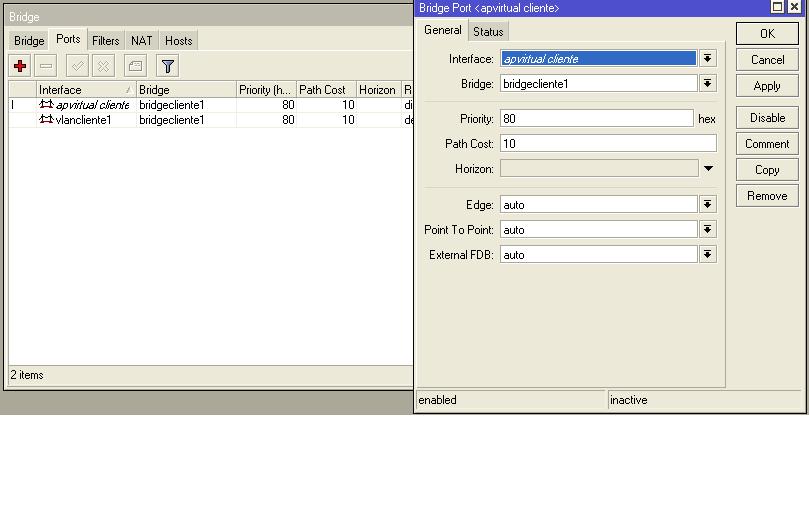

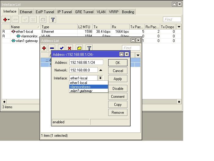

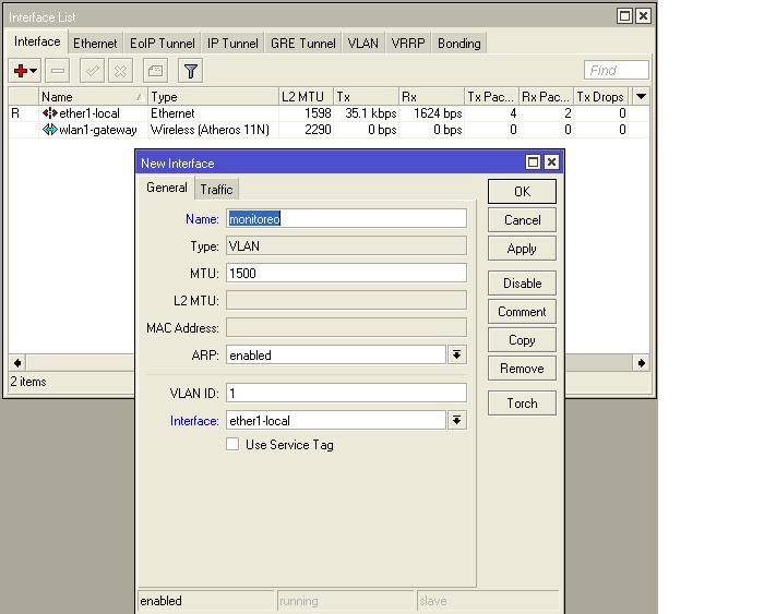

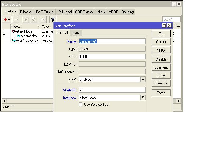

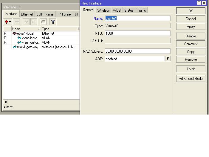

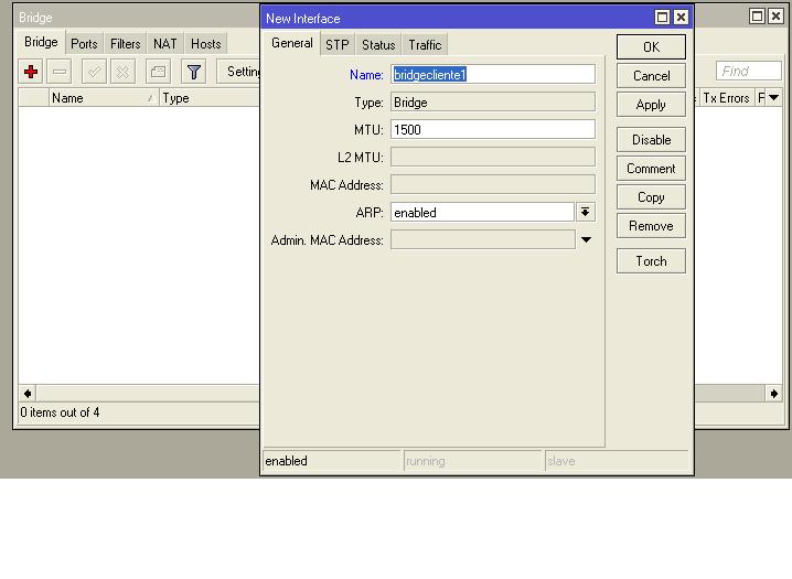

I have implemented a network I so, I will make the diagram and put it here to tell me if this is how you want it
Thank you, looking forward
Note that you must not use the eth port on the bridge, this is because the vlan are linked to eth port and should not add on any bridge, the port of your switch must be in trunk mode and you can only monitor done by assigning a vlan for that.
for all other customers must do the same process with the exception of monitoring valn it is only once.
Good luck, hope you serve.
cont..
cont.
