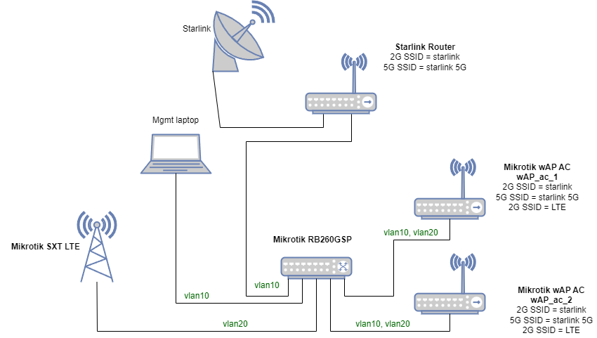

Several days ago I created the following set up:
As far as I could tell it has all been working fine, but today:

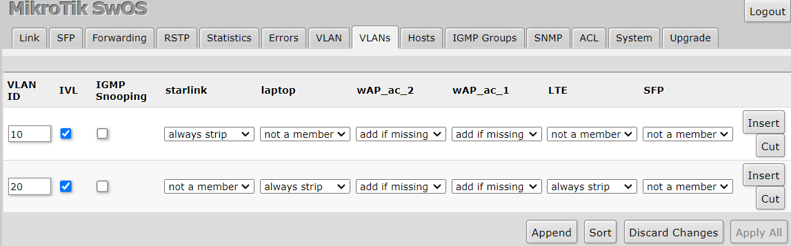

VLAN configuration of the SwOS switch:
