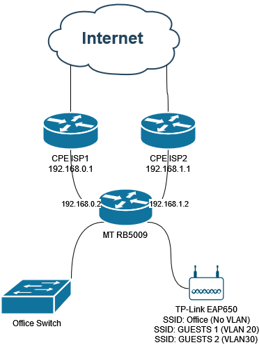

I have the following “Home Office” setup:
Two “Routers” from two different ISPs providing internet
ISP 1 is connected to eth7 (WAN1) of the MT RB5009
ISP 2 is connected to eth8 (WAN2) of the MT RB5009
Office switch and devices hardwired to the MT RB5009
TP-Link EAP650 Wireless Access Point
Provides 3 different Wifi’s (SSIDs):
SSID: Office (no VLAN tag)
SSID: Guests 1 (VLAN 20)
SSID: Guests 2 (VLAN 30)

I’m using firewall mangle rules to to “force” wifi guests 1 to use ISP1 and wifi guests 2 to use ISP 2
My ISPs are both unreliable (can’t change that) so i’m constantly switching between them. For Office i just adjust the distance of the default routes in the route list. For the VLANs i adjust the routing mark of the mangle rule. Also if I need all the bandwidth of one provider, need to be able to change the two guest VLANs to use the other ISP.
