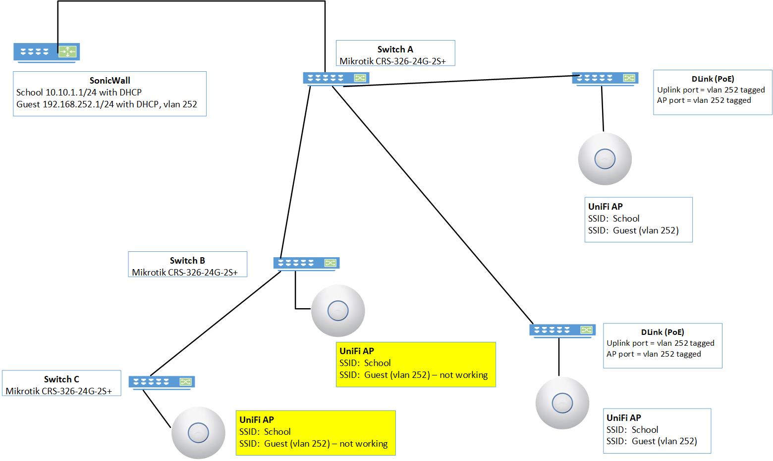

Here’s my situation: I’m trying to help out a school. They have a SonicWall router with school network of 10.10.1.x, and a guest network of 192.168.252.x on VLAN 252. The have Ubiquiti UniFi APs running two SSIDs: School and Guest (with VLAN 252).
The SonicWall feeds a Mikrotik CRS-326-24G-2S+. From there they have a couple old D-link PoE switches with APs off them. Those D-links have VLAN 252 tagged on the Uplink port & on the ports for APs. Everything there is working as it should, but there is no VLAN configuration in the CRS switch (Switch A in the diagram).
In another building they have another Mikrotik CRS-326-24G-2S+ (Switch B in the diagram). This is connected to Switch A via fiber. The school network works just fine, but the guest network will not work. No IP addresses are handed out DHCP and even with a static IP there’s no network connectivity. The VLAN is not being pushed through.
Since the D-links work, I tried only configuring Switch B. But that didn’t work.

What am I missing? And why do the APs off the D-link switches work without any configuration in Switch A?
