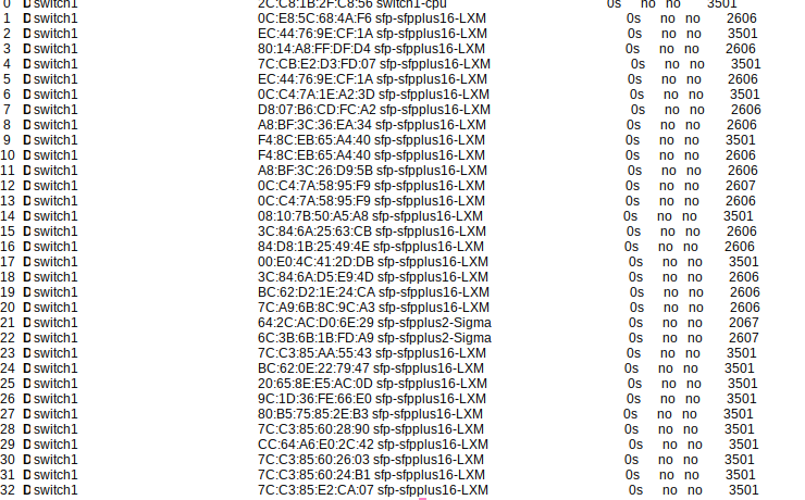

using crs 317 6.86.4. Eventhough sfp 16 is not allowed with vlan 2606. I see mac address on the this port with vlan 2606.

Without seeing the configuration from /export hide-sensitive it is difficult to say, likely missing port ingress filtering.
ty
crs317.rsc (4.38 KB)
You have only specified ingress-filtering=yes on bridge ports sfp-sfpplus2-Sigma, sfp-sfpplus16-LXM and the bridge itself (which is the bridge-to-CPU port), all the other bridge ports will permit ingress of any VLAN ID.
As you have filtering on sfp-sfpplus16-LXM it may be that the bridge hosts table is populated before the packet is dropped, you could open a support ticket and see what Mikrotik say.
