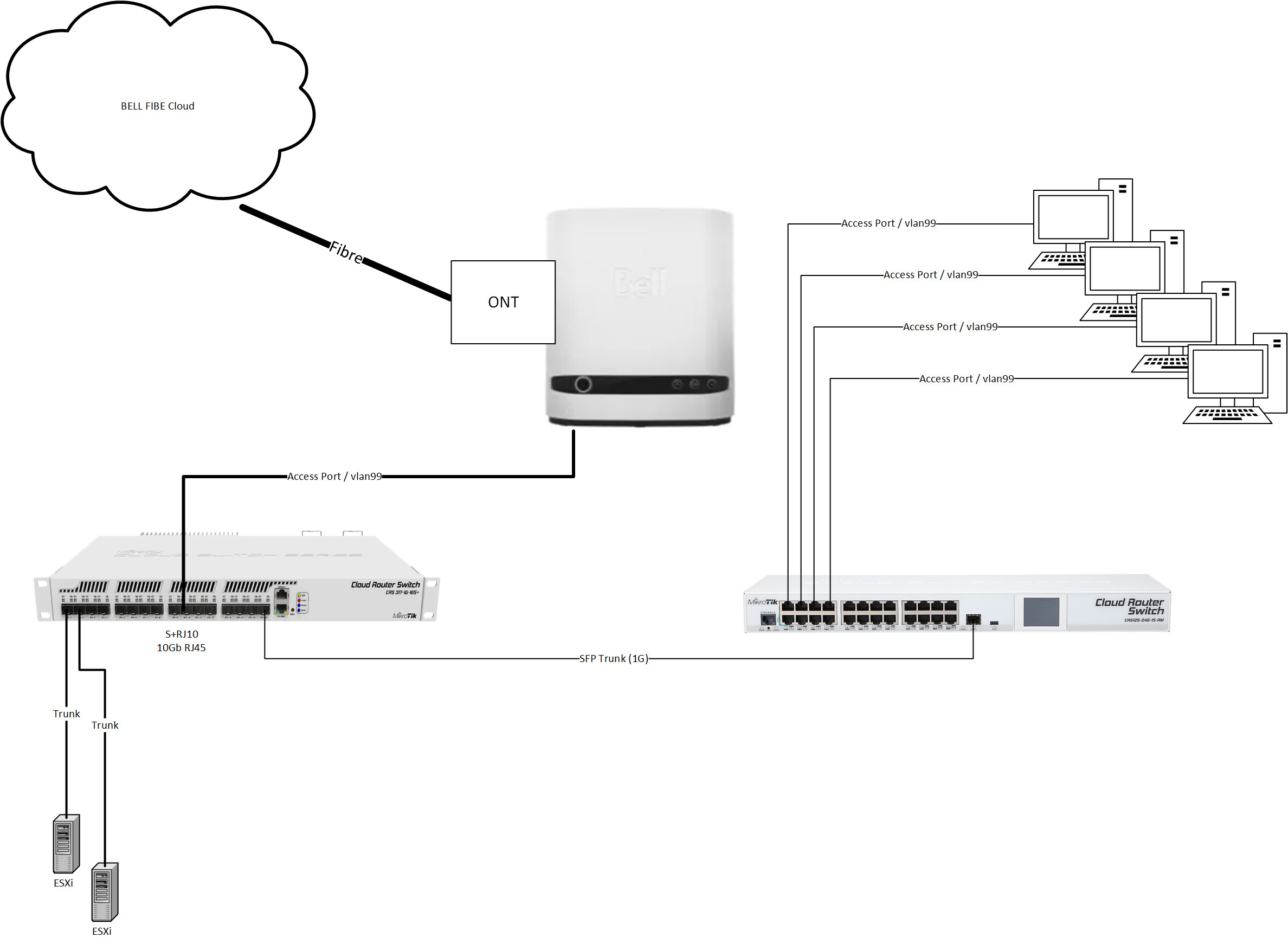

He’s a pretty picture of my network topology:
