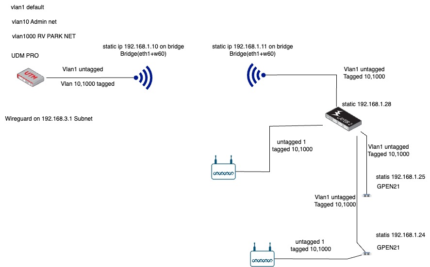

I’m sorry, I don’t follow the layout of your network. You may want to make a simple diagram of your network (router, PTMP link devices, wireguard) …
Router is Unifi UDM Pro
Mikrotik Cube60 SA to Cube60 PRO links
Wireguard default config no limits. Can ping everything on this picture , but not the 2 Cube60s…No special config, just static ip set, but can’t reach them.
If this statement is about cube devices … then they need at least default route set with UDM’s address as gateway. Without this setting (and probably DNS settings as well) it’s not possible to use built-in package upgrader …
