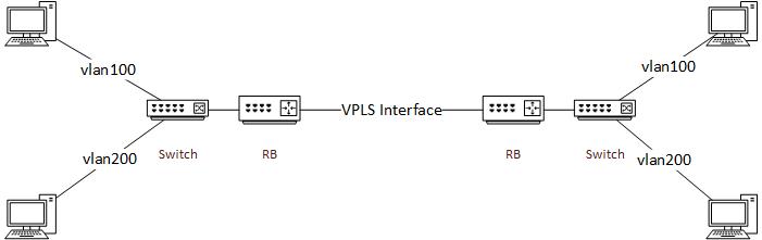

good day. I need bridge several vlans over one vpls tunnel. can i implement this sheme?
i try make like on eoip tunnel: create vlan100 on ethernet and vlan100 on tunnel interface, but when i try to add vlan on vpls interface, i got error: failure: could not set mtu
You don’t need to add vlan on vpls interfce. add vlans on ethernet and bridge them with VPLS tunnel.
but if i bridge vlans, then vlan100 and vlan200 also bridged
Then bridge only vpls with ethernet, vlan tags will be forwarded over the tunnel and will be managed by switches.
ok, i have vlan 100 on ethernet1, i have vpls interface. if i get you right i must bridge ethernet1 and vpls interface, right?
