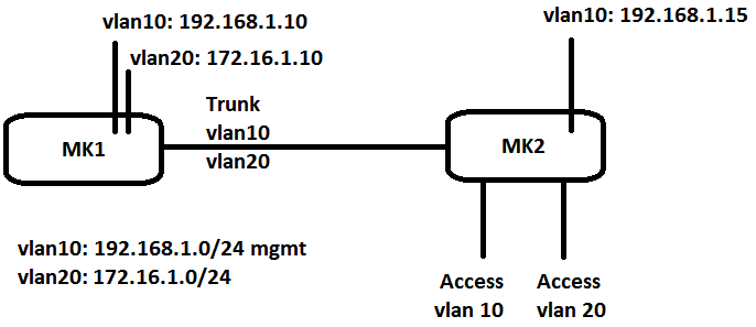

Hello guys,
I have already read some articles and posts about this topic. Also I have read the manual of mikrotik. But Im unable to run this simple topology. I also put here the config files. Maybe I just missing something. When I configure Vlan interfaces to every MK then it works fine, but I dont need interface VLAN20 on second MK2. I just want to make vlan interfaces only on MK1. MK2 would serve as L2 switch without any routed interface except mgmt intervace vlan10.
So when I dont have vlan20 interface on MK2 and I plug PC to Ether5 which is access vlan 20 the PC doesnt have connectivity to VLAN20 interface on MK1. When I configure vlan interface on MK2 then it has connectivity to vlan interface 20 on MK1.

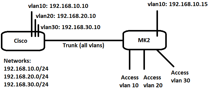

So I would like to react to my own post. I’ve changed the topology a bit. I don’t use the first MK1 anymore and I changed it to Cisco platform. But this change is really minnor so I don’t think that it is changing something anyway. MK2 is actually CRS210-8G-2S+IN and I use it with firmware version 6.38.1
Here is my config from MK2 and it works for me:

Without switch1-cpu parameter in the /interface ethernet switch egress-vlan-tag part the vlan10 interface is not reachable from cisco and also the vlan10 interface on cisco is not reachable from MK2.
I tested it and it seems that it works like I wished to. I will do some additional tests.
