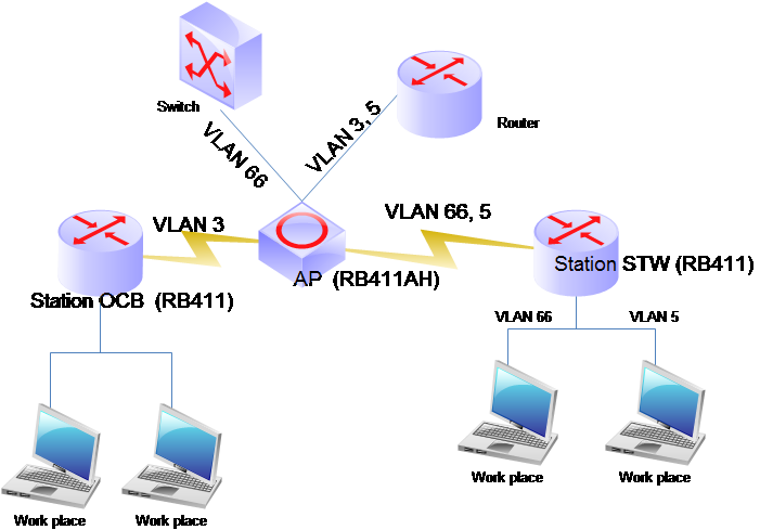

update:
I have uploaded/attached an image of the schematics.
The setup includes 2 x RB411 and 1 x RB411AH. The two RB’s used as station can only be a station an no AP (license restriction).
The purpose is to provide 3 different type of services/different circuits to the equipment behind the stations.
the wireless links are WDS and whether or not i use VirtualAP’s on the AP end, does not seem to matter so far, when having a dedicated VLAN per WDS link. However, now that I need two VLANs over one WDS I seem to struggle.
Has anyone any suggestions?
