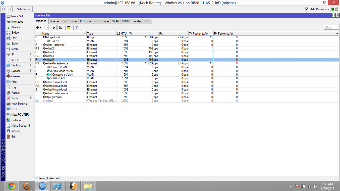

Newb question: Using an RB2011U and setting up a couple VLANs. Can get everything working as planned on port 6 (master-local) but would much prefer a Gigabit connection to my switch (Prosafe GS728TP) from one of the ports 2-5. I’ve tried a number of different things but can’t figure it out.
Thanks.
It should be the same process. If it isn’t working as expected on the Gigabit ports check whether the relevant interface is slaved to another.
Screenshot is attached (can’t tell if it’s working or not…)
I’ve tried various ports, but looking specifically at 5 under ‘Master Port’ it says ‘None’. I’m thinking this has something to do with ‘Bridge-local’ but I can’t figure it out.
If Port 6 was gigabit I wouldn’t have an issue, but 6-10 are fast ethernet.
