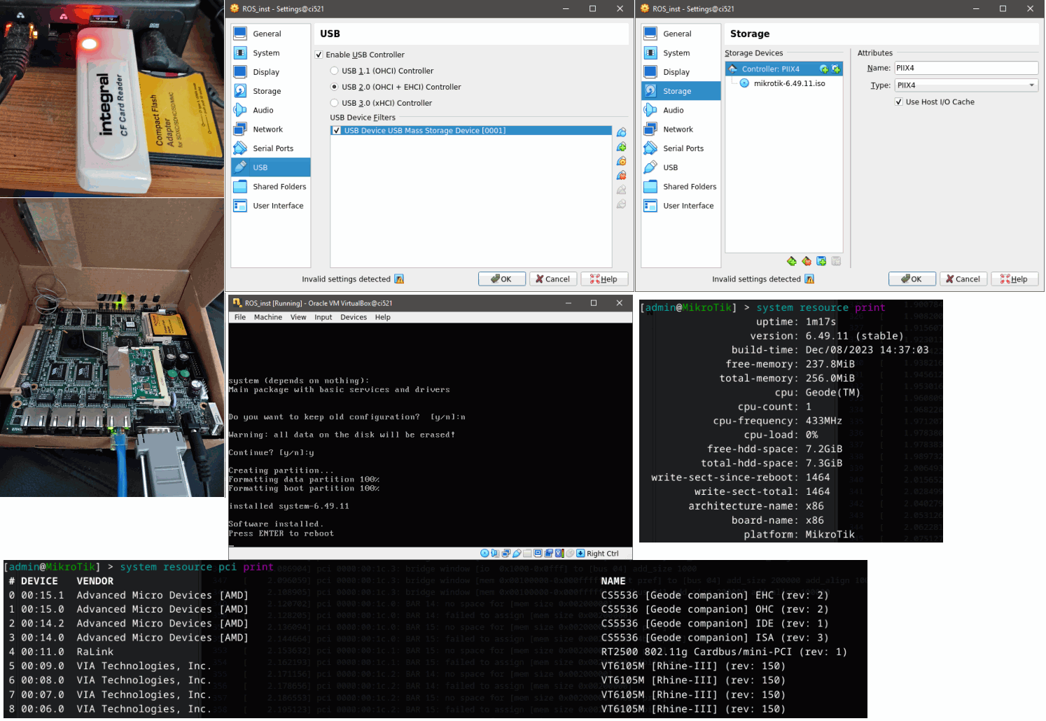

experienced the same problem with V7.x…also with newest 6.49 version…but worked with 6.49.11… but maybe this was just luck and there were writing errors before ?
maybe it’s best to avoid UEFI-calamities with V7 … flash a V6-version then upgrade to V7
after install there is absolute no config … no auto-setup-script … no 192.168.88.1… and the board is totally numb, exept the serial-console on ttyS0 (9600/8/N/1)
