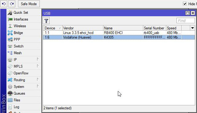

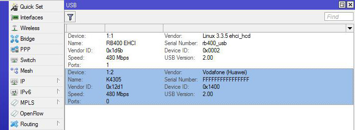

I try setup a Vodafone K4305 usb 3G modem on a routerboard 751G-2HnD
I see the modem to recources usb but what must i do to install the modem?
No usb port see.
If connect the 3g modem blinking the green light.
Youre help is welcome
RouterOs 6.7

check if you see a lte1 interface in the interface menu and if yes, try to add a dhcp-client on that interface.
Thanks Uldis it works
