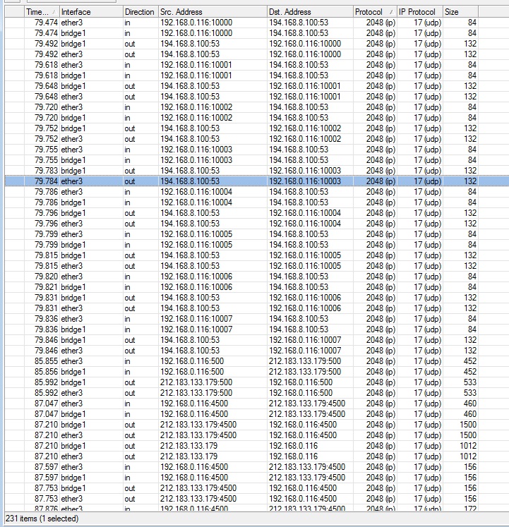

did you try to sniff that device’s traffic?..
Not yet. I’ll try and get that done today - I didn’t have much time yesterday to play with the unit.
here are the results from the packet sniffer: (sorry not sure how to export them)
nice, but… what are those addresses? :smiley:
Lol – very sorry about that - I wasn’t thinking what I was doing.

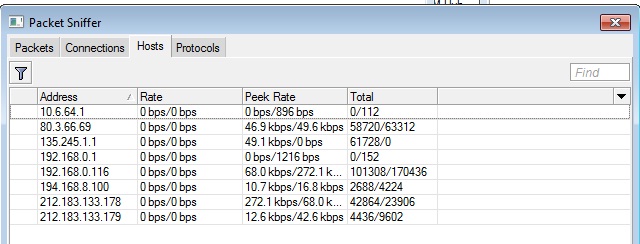

here we go:
Ok this is strange I just restarted all my VOIP phones and the vodafone unit just started working without any issues?! Any idea why?
reboot helps frequently :smiley:
“have you tried turning it off, and then on again?” :slight_smile:
