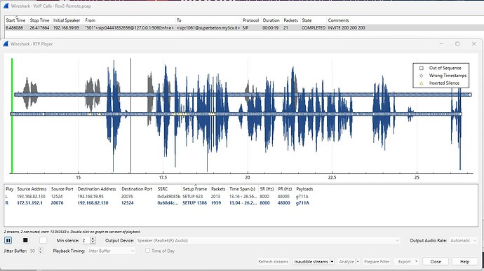

It’s a mess this time. The single call in “central” and “remote” captures is not the same one, and the capture from “3cx” sends the SIP messages between two local processes across 127.0.0.1.
To be able to say something, I need a capture of the same call from the router to which the phone is connected (which, I suppose, is one end of the Wireguard tunnel), from the router that is the other end of the Wireguard tunnel, and from the outer interface of the SBC (the IP to which the phones register). And pcap file names that clearly indicate which one is which.

Call is the same, the captures was made at same time at RB on both side of Wireguard tunnel and 3CX pbx.

I don’t get it. The only call in “remote” is at 12:00:02, from 501 to 1601, Call-ID 7-44Ub0OL5NSjkjmcN94jA.. The only call in “central” is at 11:52:30, from 1270 to 1270, Call-ID d3Rz1_aeZjjXSCHjjjVcPA.. . How are these two related? The time spans of the captures do not even overlap …
Draw a network diagram, indicate how the tunnels are set up, check that the times are correct on all routers, and capture at all places simultaneously.
That’s the call in remote:
