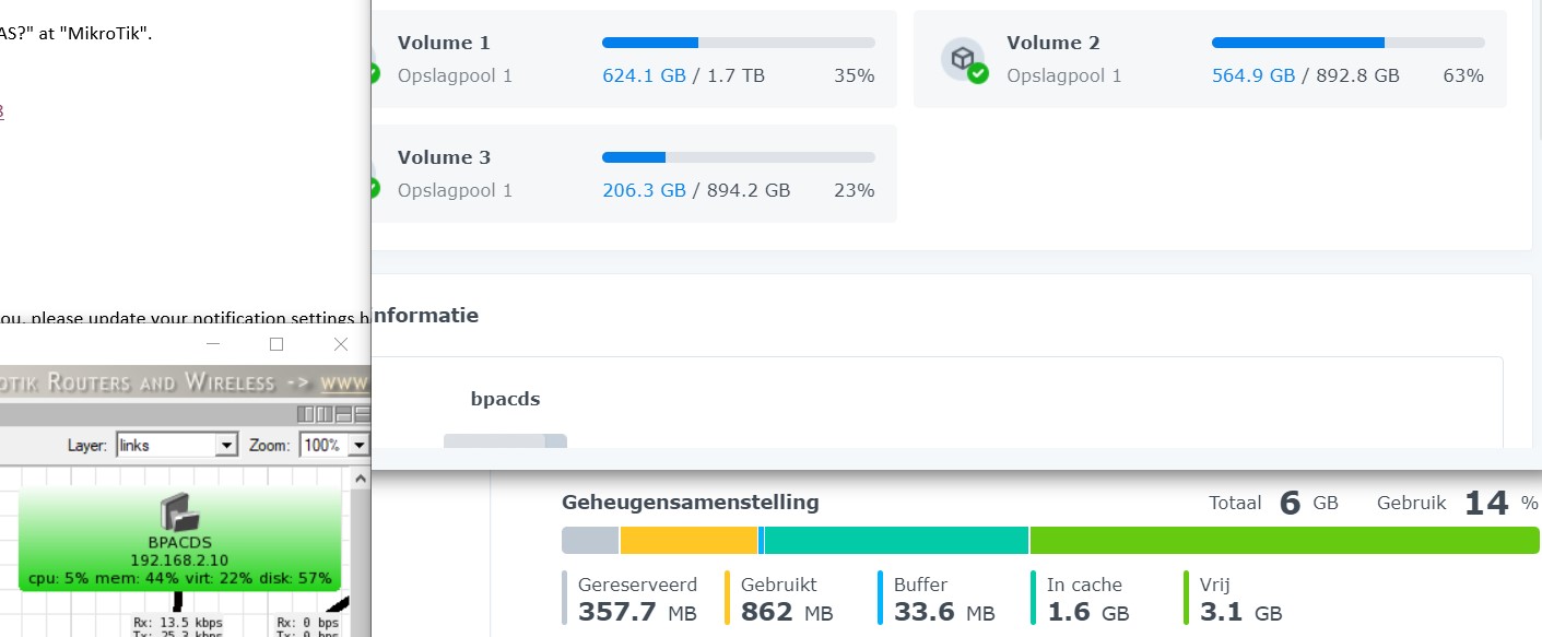

I have Synology NAS in my network, and I have noticed disk usage is indicated wrong on the label.
The Dude reports 46% usage, but Synology OS reports 69%, see screenshot.

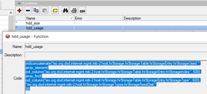

Did not really understand yet how things work in Dude, but seems like Dude’s function hdd_usage() returns wrong value for Synology…
See picture for device label.

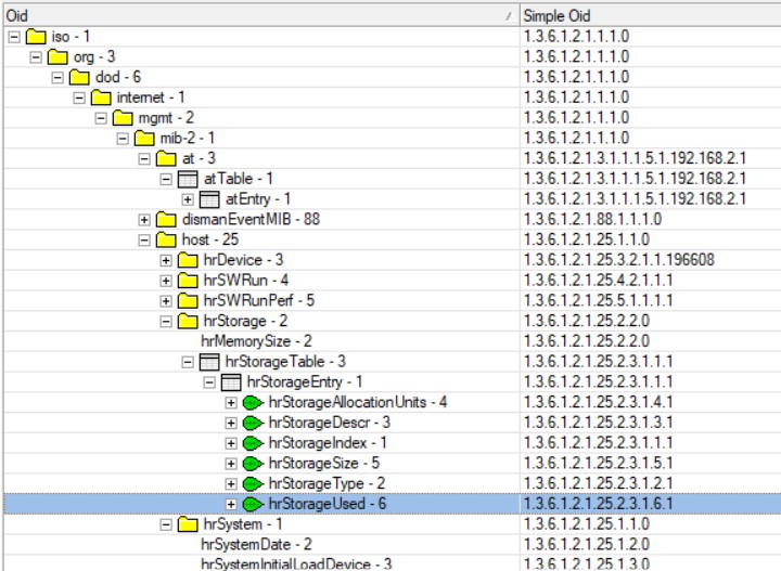

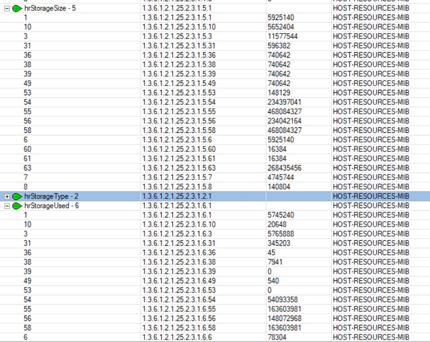

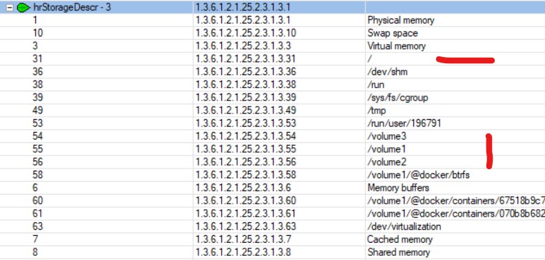

SNMPWalk gives: (volumes are 54,55,56 in my case)

Your point is: disk_usage() function is not applicable for NASes and I need to use some Synology-specific snmp oid staff, is this correct?
YES

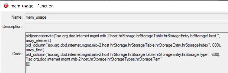

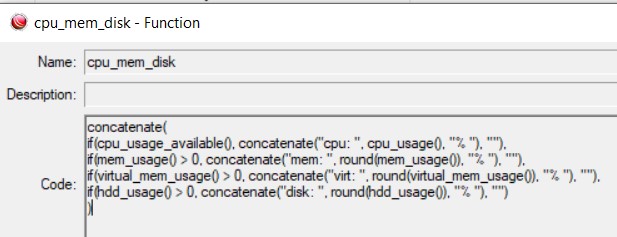

I don’t know what device_performance () collects. What is the disk value that is used? And memory? It does not seem to be related to the NAS volumes?
In the NAS itself I find no correlation with the shown values for memory and disk.
Nothing seems to explain the values: AHA found it:
This function shows the % usage for the filesystem “/” , not for the mounted file system “/volume1”. In OID under number ending on 31, not numbers 54,55 and 56
The values in the OID are correct for all the mounted file systems, and there are many of them (even more detail than in the GUI)

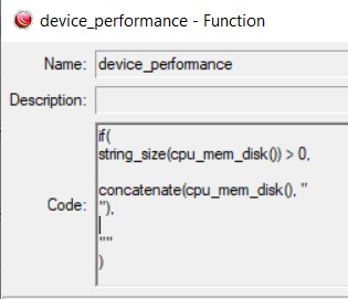

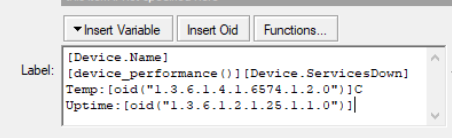

P.S. What does first line report: [device_performance()][Device.ServicesDown] ?
I did not see any relevant parameter, seems like it does not really informative in case of Synology NASes…
[device_performance()]—> found in functions (double click, or right-click/settings)
[Device.ServicesDown]—> probably comes from probes/services
etc etc etc etc

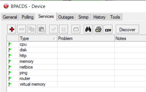

Services checked (list made with “Discover”)
