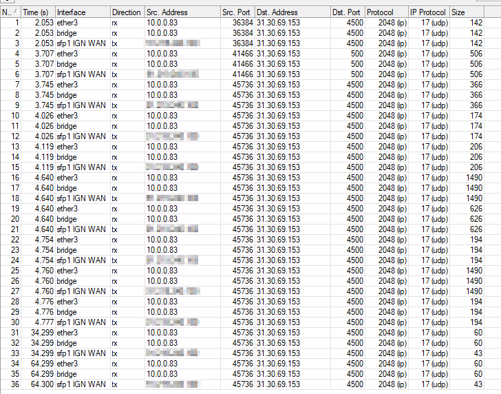

This is what sniffer shows (filtered to IP addresses = 31.30.69.152 and 31.30.69.153):

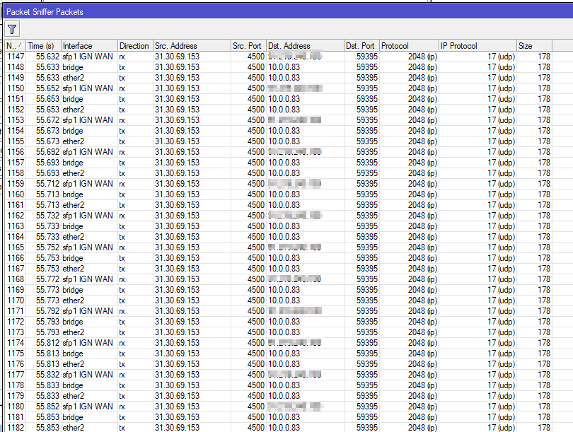

Btw, upon activation, I see following comm - do you see anything missing or does it look OKay ?
Obviously, obfuscated part is my public IP
It kind of looks like it should almost be working, not sure, wait a while?
