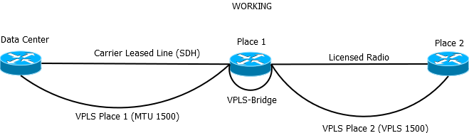

Next update.
Replaced all Routers on this line to the customers including the one in the data center. (now 3x RB1100AHx2 with RouterOS 5.19)
All routers are configured manually from the scratch.
Same problem. The VPLS-Tunnel to place 1 works with 1500 Bytes and the VPLS-Tunnel to place 2 only with 1478 Bytes.
This is not working:
Now I changed the config in this way that I create a new VPLS-Tunnel between place 1 and place 2 and attach both tunnels to a new bridge.
The OSPF interface mode are set to PTMP on the used interfaces.
This is working:
So where is my mistake? Why is it working with two tunnels and a bridge between and not with one tunnel directly from the data center?
