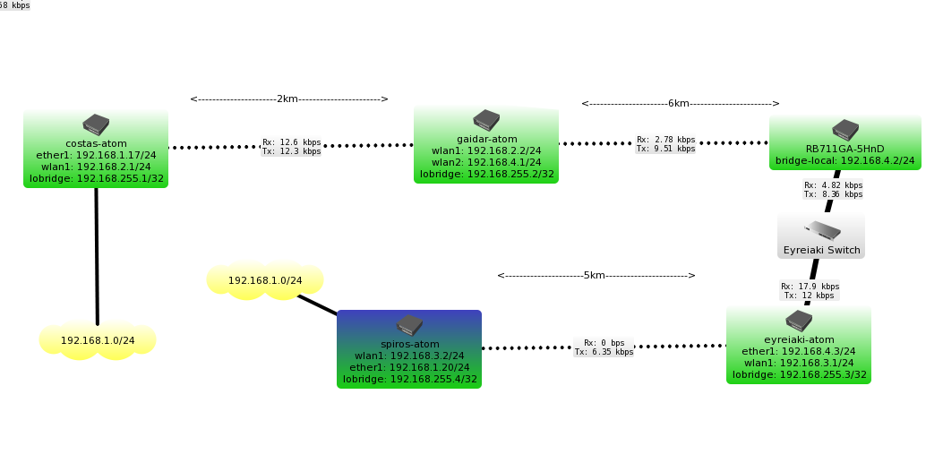

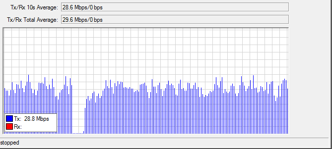

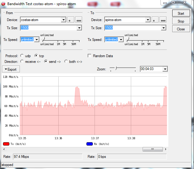

When i stress a VPLS link with traffic, it fails for a few seconds while none of the underlying wireless and wired links fail.
You can see this from the attached screenshots, while i was running two bandwidth tests at the same time, one over the VPLS link and one over MPLS.
I believe this started when i inserted the RB711GA-5HnD into my network.
my network was created according to this example http://wiki.mikrotik.com/wiki/Manual:MPLSVPLS
ROS is 5.7 for the atoms and 5.8 for the RB711
