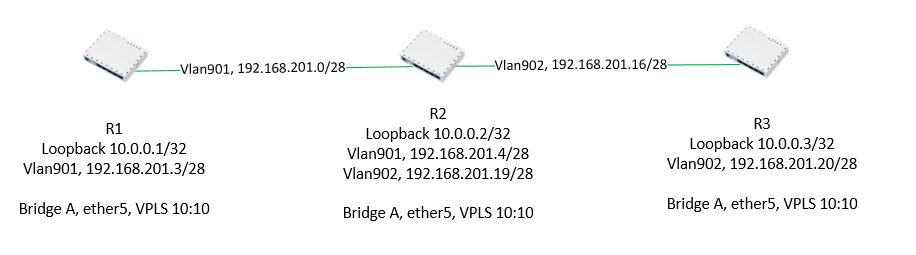

I have been trying to create a bridged environment across ether5 of 3 RB750GL routers. (I eventually want to get to about 5 sites with this config)

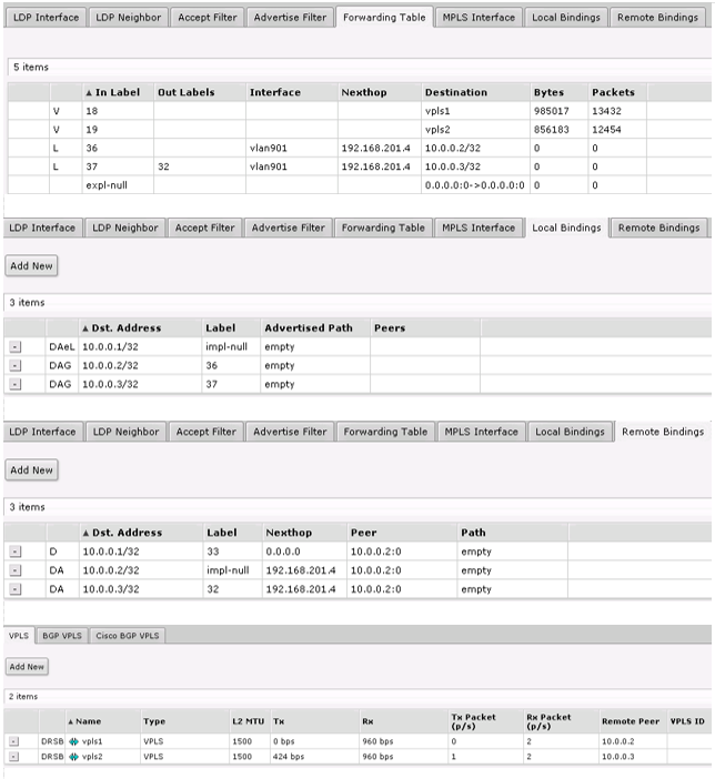

I followed the directions here: http://wiki.mikrotik.com/wiki/Manual:MPLSVPLS and had OK results (after working through my transport MTU issues… that was FUN!). I was showing MPLS full mesh and some VPLS tunnels usually coming up. I could get the VPLS tunnel from R1-R2 and R2-R3 every time. Getting R1-R3 working required rebooting either R1 or R3, hard to predict.
I then tried converting BGP based vpls. http://wiki.mikrotik.com/wiki/Manual:BGP_based_VPLS
At this point, R1 and R2 are working fine. R3 hasn’t worked much at all. I’m not sure what I might be missing at this point. Any suggestions?
Diagram
R1
R2
