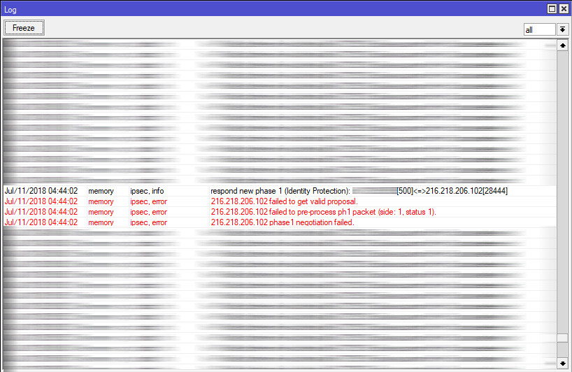

every night someone trying to connect via vpn to my mikrotik. It’s going on for about last 1 week. Have enabled L2TP/IPSEC.
IP address is 216.218.206.201, 216.218.206.206 etc. (changed every night)

The nightly scans are ISAKMP vulnerability probe requests executed by the Shadowserver Foundation. Actually nothing to worry about.
https://isakmpscan.shadowserver.org/
We are querying all computers with routable IPv4 addresses that are not firewalled from the internet with a specifically crafted 64 byte ISAKMP packet and capturing the response. We intend no harm, but if we are causing problems, please contact us at: dnsscan (at) shadowserver (dot) org.
