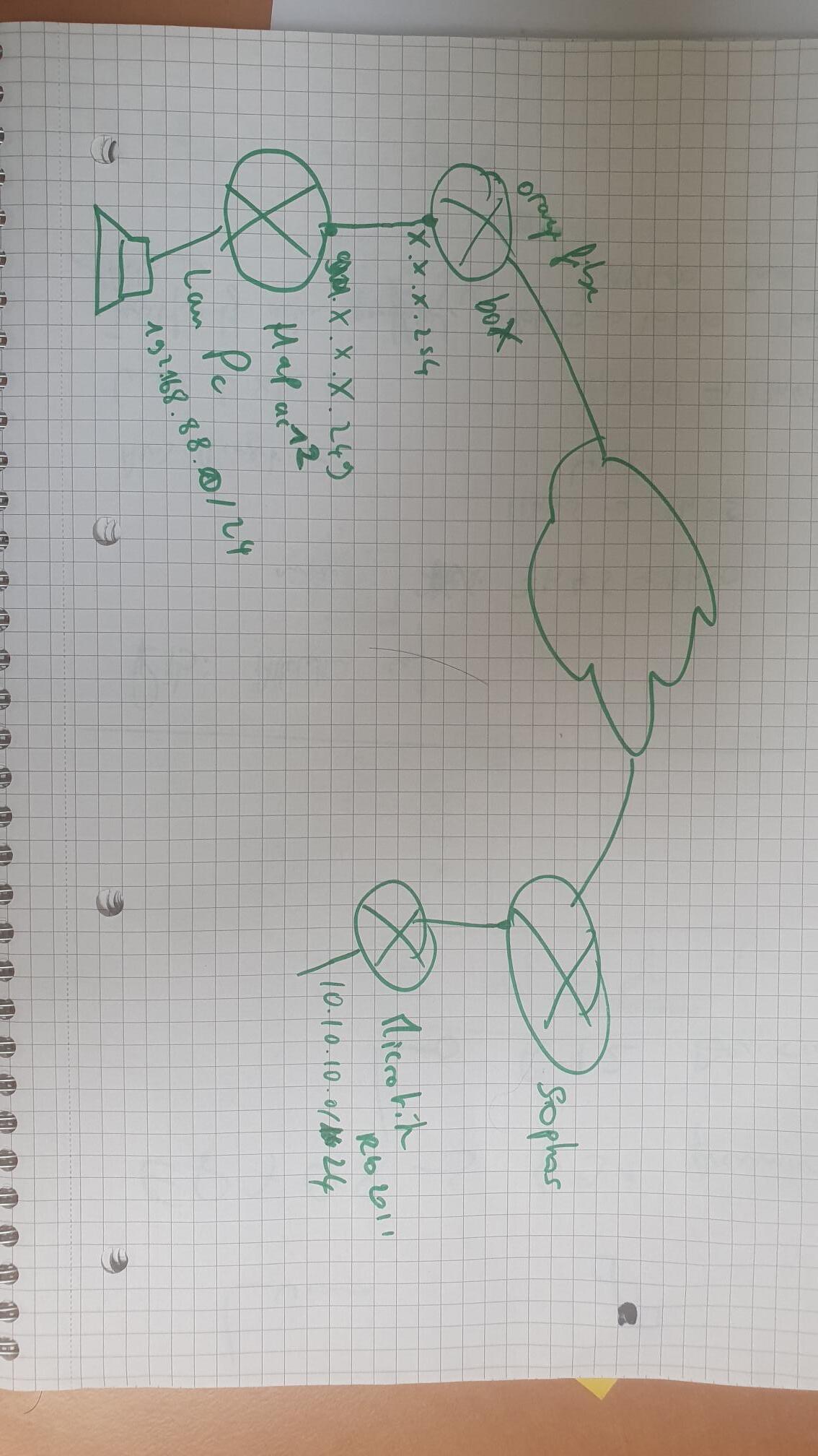

I have a rb2011 behind a sophos (I CANT MANAGE THIS SOPHOS) and i have a HAP series in my company.
I want create a vpn between this two equipement.

Best to make an as complete as possible drawing indicating which device is sitting where and what other devices are in between (a cloud for the Big Internet will be sufficient :laughing: )

This is the schema (im french i can more explain in french)
No problem with French but for IT stuff I prefer English :slight_smile:
Do I see correctly your other Tik is hAP AC2 ?
Bbox from Orange, can you do port forwarding on it ?
Yes i can

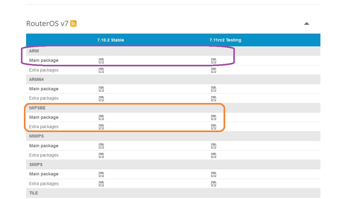

The WireGuard menu is not present on my MikroTik router. Could you please guide me on how to install it?
Hmm, what version of software are you on? Suggesting 7.11rc2 unless its production and thus use 7.10.2 stable.
Best to ensure you download the correct version of the software for your router,
For example RB2011 is MIPSBE ---->
HapAC2 is arm32 ---->
