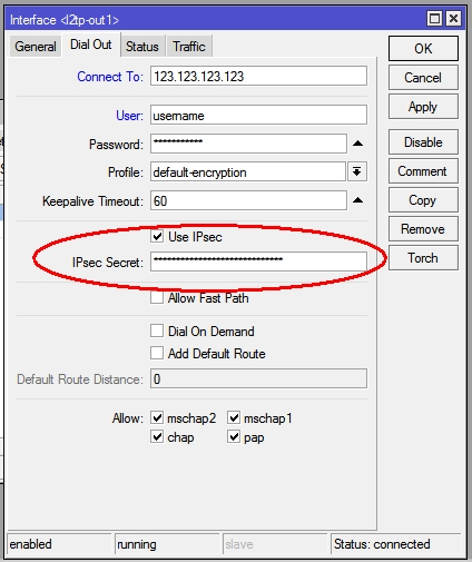

Experimentator Can you tell me where do you see the “use IPSec” and a place for password on the CLIENT side (the one with dynamic external address).
I can see these options only on the server side, after pressing the L2TP server button. But I cannot see anything like this while creating the L2TP client on the other router.
Thank you.
Sure!
In Winbox, I set up the client under PPP → Interface
Then under the Dial Out tab, you’ll have the ‘Use IPsec’ tickbox and the Secret field:

Well, you’re more lucky than I am. My home router does not have this option. All I have there is “Dial on demand” and “Add default route”. :confused:
I was really frustrated trying to figure it out on the client side. Now it seems that… what exactly? That my RB does not support it or do I have to upgrade the OS?
You need to update it, this feature was added a while ago though, so you should be using an at least several months, maybe half year old ROS version.
Don’t forget to check System > Routerboard Current Firmware vs Upgrade Firmware versions afterwards.
frytex, I also believe you need to update your RouterOS. Check your current version and update to the latest one available!
